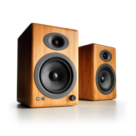

Can you return the Neumi's and get a pair of powered speakers?

That review is the reason I bought the speakers actually. Do you think I should just get powered speakers since I'm using them just for desktop and phone music? I do care about sound quality but maybe investing in low budget passive speakers is less worth it than powered?

Active speakers would be simpler and would work well in your application it seems and possibly alleviate the need for extra hardware. Personally I have a pair of JBL LSR305 active speakers, and like those a lot, particularly for the money; I've got a few pairs of passive speakers I've run on a d class chip amp, too but have to give the edge to the JBLs for the $. YMMV.

Thanks for the help man.

these will be on my future upgrade list. thanks
ordered it, can't wait. Thank you!
Did you notice these speakers don't use rca connectors? They accept 1/4" and xlr type connectors so with most consumer gear you'll need appropriate adapter cables....
