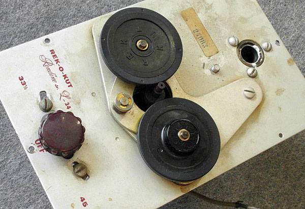

highfigh, you mentioned, "Don't let the motor try to start if it doesn't want to- that could damage the winding."

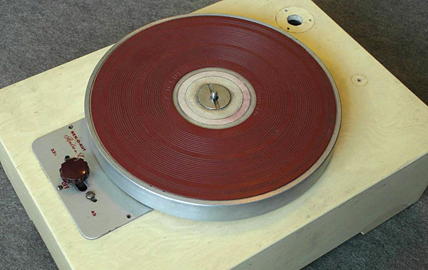

Today I went to see if the turn table would work from the get-go since it did work the other day. Unfortunately, when I set the Rek-O-Kut to 33 1/4 it started to turn about 1 revolution per minute as before. I recalled what you wrote earlier about damaging the winding. Would you happen to know what could be the cause of the motor not coming up to speed? I'm assuming the motor itself is good, but something else is causing its delay?
Seeing that both the Tuner and Multiplex AC plugs were connected to the Control Amp I surmised the connector may be Switched and the main problem was the Control Amp. Through process of elimination, I connected the Tuner & Multiplex AC plugs directly to AC. The AM/FM Tuner Face and other tubes show power. The Multiplex does not display the Power light but its Beacon does come on for a bit and turns off. If I unplug and replug the Beacon will display and turn off. I didn't look at the tubes of the Multiplex because I had my other equipment on top of its compartment. With that said I believe I may have possibly eliminated 33% of my problem with the Fisher gear. I see what appears to be a huge transformer on the Control Amp chassis which could possibly be the problem.
I hadn't looked closely at the shot from below and thought that it might be direct drive. This turntable uses idler wheels to drive the platter, as shown in the photo- the surface of the rubber becomes hard over time and that prevents it grabbing the drive spindle and platter, so I suspect the spindle is slipping, which would definitely prevent the platter starting quickly.
Rotate the platter with your hand- does it spin easily, or do you feel resistance? If you feel resistance, remove the rubber mat from the top of the platter and look for a way to grasp it, in order to lift it off- the hole near the upper right in the photo (with three screws) is where the post on the platter fits and it should come out easily enough. You may need to rotate the platter as you lift it and once it's out, you can clean and lube the post and bushing to make it ready for new lubrication. Vaseline may seem like a good option, but it hardens over time, so white Lithium grease is a better choice- you should be able to find a small tube at an auto parts store.
