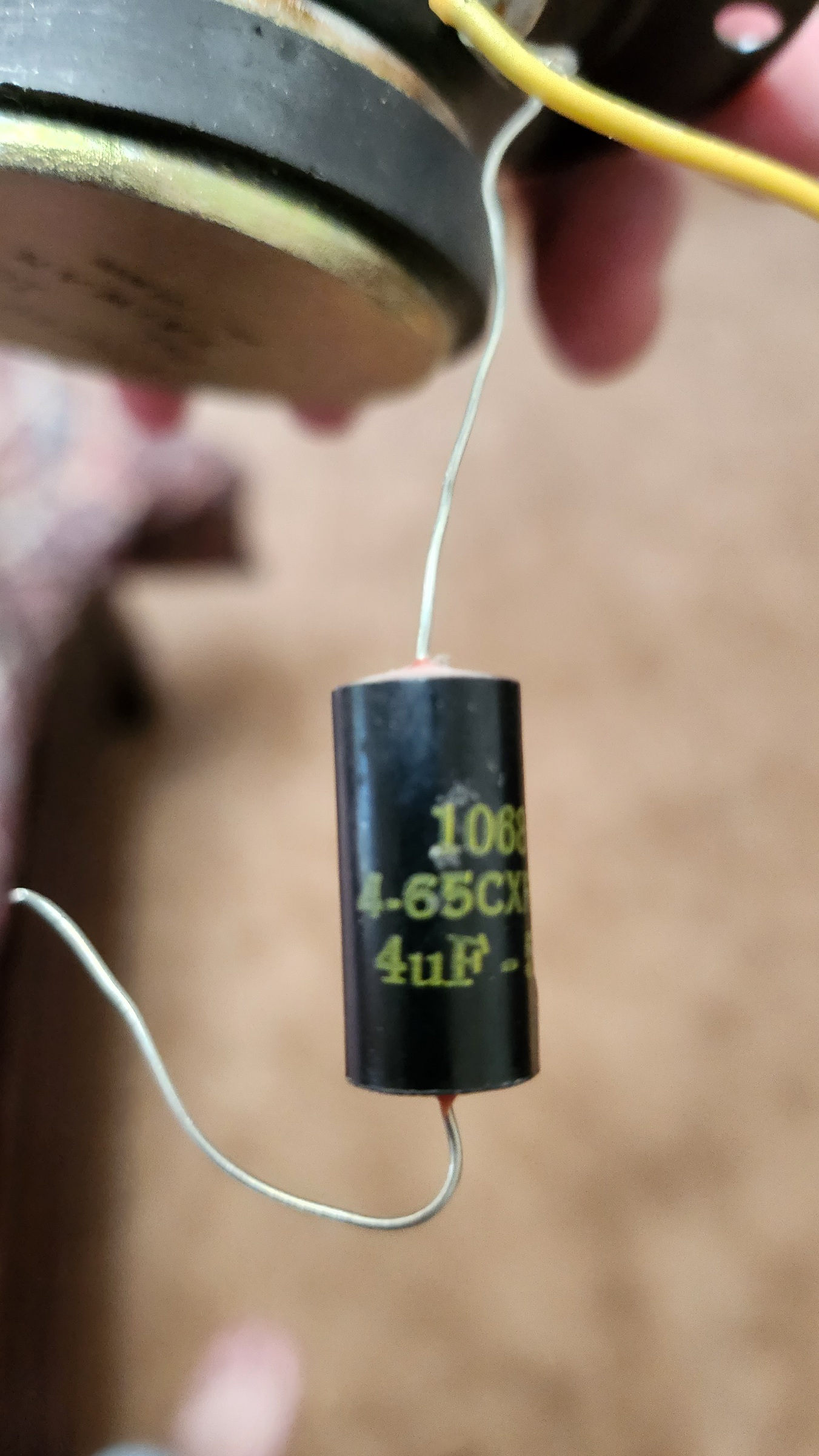

Hi everyone, my Dad back in 1981 had a pair of speakers built out of his favorite wood (Koa) and he recently gave them to me in really really bad condition needing all the speakers and capacitors replaced. I decided to do the work myself and im finished and they work but could sound better. Was curious if anybody who lives in Las Vegas has the experience to analyze these speakers and make corrections (building new crossover, maybe port) to make them sound amazing?!! Since im a newbie this is out of my expertise. These are sealed, and all replacement speakers I bought off of partsexpress.com. Feel free to reach out to me with recommendations of anyone who can service these in Las Vegas. Thanks, Britt.
P.s. Side by side picture is old speakers (15" passive radiator) and new speakers with 15" woofer.

I'm sorry, but I have to tell you honestly, that whole design concept is beyond help. The design concept is beyond dreadful and terminally flawed.

I like to give honest answers and not false hope. There are just far too many drivers, and even the most advanced AI could not sort that lot out.
If you want help doing a design from scratch I could help you.

To echo TLS Guy, that speaker is fundamentally broken. It looks like the midrange is being split up between three different drivers. The only thing resembling a crossover circuit is two capacitors. There is no way to reasonably design a crossover that could accommodate all these drivers or even half of them probably. Not to sound snobby, but that is not a salvageable design, at least if you are interested in high-fidelity playback.
Should have asked before buying the drivers. Might post up what drivers you bought, maybe something can be designed from them for new boxes....

You also replaced a passive radiator with an actual woofer....

I would take the wood for it and make some bookshelf speakers. The wood does look very nice, and it could still be useful for a good speaker. I bet you could make some killer two-way bookshelf speakers with that material.

Yes these are all great recommendations. I'm holding on to speakers bc of their sentimental value. Family is very strong with us and I'll probably just use them to look at!! I didn't design them, just trying to do them proper justice. Understand now that the design is faulty and they have been relegated to art. Appreciate all your comments and advice. The wood is pretty though I must say!
