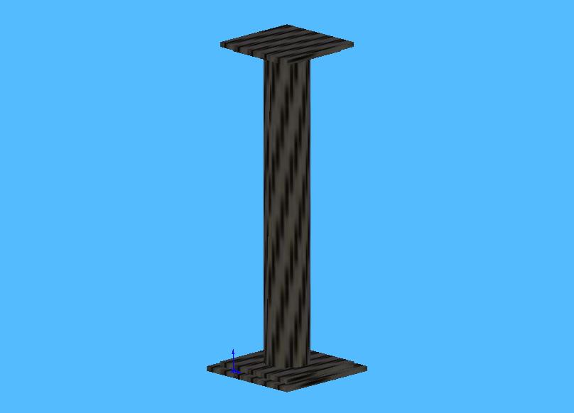

Your best bet is speaker stands. The ceiling mounting has been done before but I wouldn't be too crazy about doing it myself. It would make everything sound like it is coming from above you. Speaker stands are easy enough to make. I know there is one idea in the diy section you can also search for them on the internet (DIY Speaker stands) I have been thinking about makinsome for sometime. You can also get some for fairly cheap ($50 pair??).
The easiest sounding idea I have heard for making them is using 3" PVC with a nice looking square peice of wood on each end. Use a piece of threaded rod going through the middle of the pipe and bolt the wood on at each end. Attached are some pictures of what I am talking about. I had drawn it up in Solidworks a while ago jst haven't made them yet. You can then fill the tube up with sand for some weight.
Edit:: You'd obviously then paint everthing to taste.
scc135,
I have almost the same layout as you and decided on moving the seating a little away from the wall and putting the rears on stands and having them elevated at 6' high or so. So far so good but I need to work on the setup a bit more, levels are a bit off. The rear on the open end seems way to distant most likely caused by the rear near the hall area getting reinforced by the wall being so close ... my best guess anyway. :)
BTW, I made a set of adjustable PVC speaker stands from 2" and 1.5" tubes. Very simple to make in about an hour depending on what you have for the bottom and top. These will be great in figuring out the best placement.
