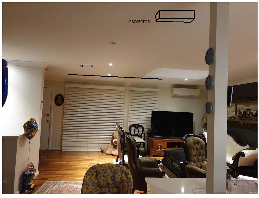

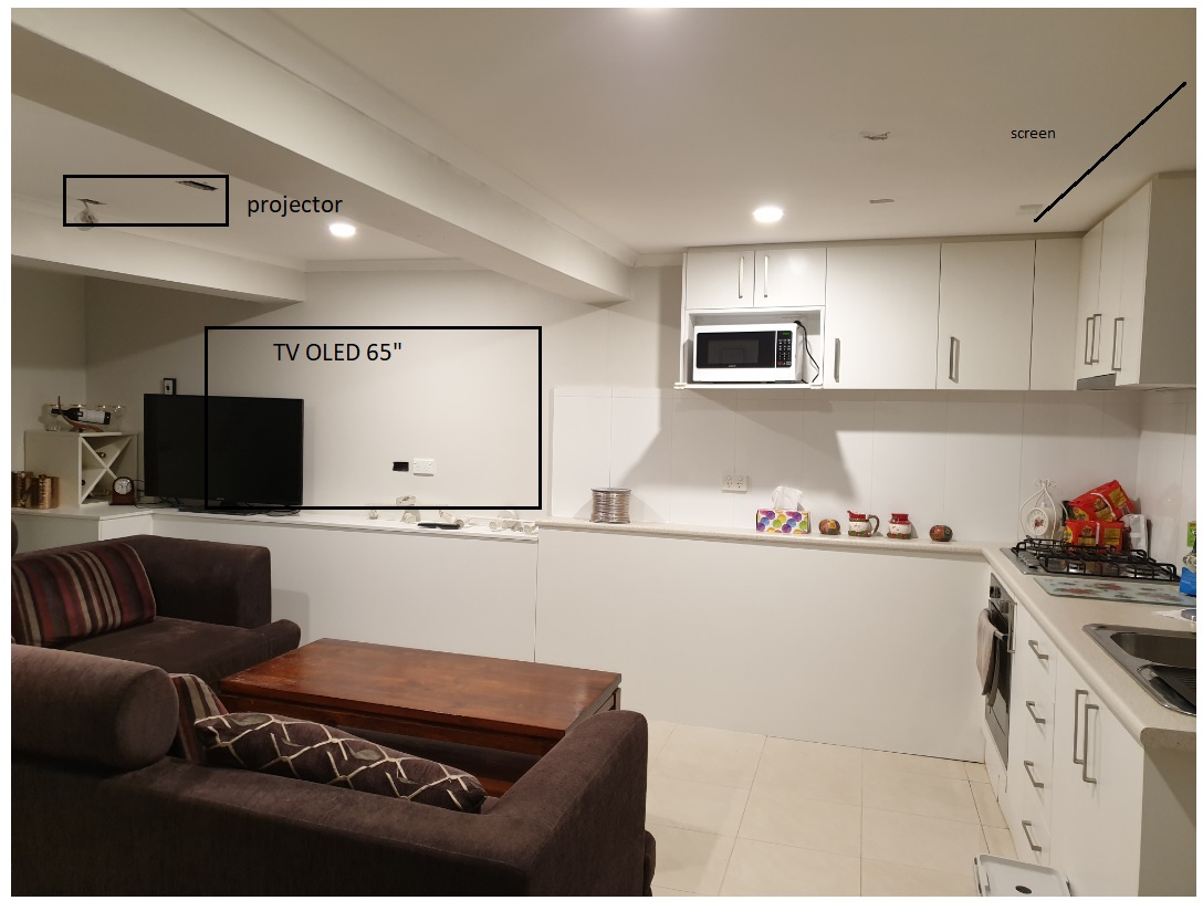

Hi all sorry to keep this going but I find another alternative to the ground floor I was talking about...in our 1st level there is only 1 possibility that I put the projector as showed as motorised with the condition nothing is exposed or there is no wire... I just need to ask as this :
- the ground floor I can turn light off and there is only 1 small windows which I can block so even during the day room can be kept dark but 1st level there are more windows so the light control is weaker
- but unlike the ground floor which I will have screen very close to the wall and cabinet, in 1st level there is 1.5 meter from both side space to the nearest wall so I think reflection is lower
- from sound, now I can have a bit better option, at least I can use the aimable tweeter inceiling ( unlike the ground floor )
- I can move the TV downstairs so we can have access to 2 media , specially in future when my 4 years old wants to see something we dont want , in ground floor I want to put both TV and projector so only 1 can be used at time
- as my office is close to the 1st level , I can put all AVR , apple TCV...in a Rack and in my Room, which also has my NAS, PC, Router ...
- Ground ceiling is only 2.1 m but ground level is 2.5m
- in ground level we are not using the kitchen but who knows maybe we have some guest and we can use it
the electrician will be here tomorrow and I need to make my mind by tomorrow...really appreciate if you advise ...please note I can chose any other location in the 1st level, believe me...
both plans - 1st level
Ground level

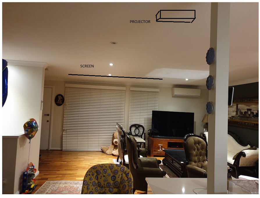

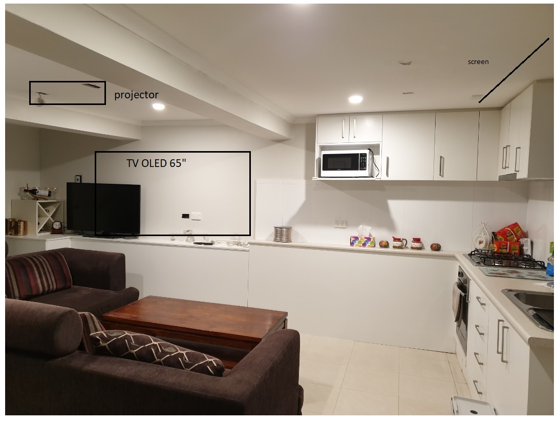

Ground level
This looks more promising.
I think though you are making a really fundamental error in your planning. This is trying to get lots of channels at the expense of quality.
I can tell you that a high quality 2.1 system gives a far better cinema and music experience than a system with 11 poor channels.
In truth most rooms are not suitable for multichannel and would be far better off with two really good channels.
I can tell you two good channels really can give you a good experience. You just have to give more than you thought you ever would for that one pair of speakers.
So in that room, I would go for a really good in wall system either side of that window. No center channel as there is the window. A ceiling center speaker would spoil it.
A couple of ceiling surrounds would not upset things, but probably not add much.
This could all be done neatly and without wires being visible.
In that lower room, where you now have placed the 65" OLED TV you could do a good 3.1 in wall system, with the center above the TV. You have plenty of room for a concealed potent in wall sub.
Here is a very potent 3.1 system, with a concealed sub.
That is my wife's rig and she loves it. The TV is a 65" plasma.
Thanks TlS, I think you are right...I used to use my headphone Sennheiser HD 800 and although it was only stereo, I had a very immersed experience watching movies...
