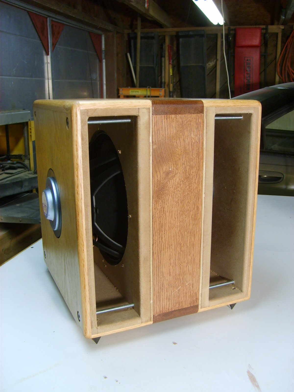

The gradient sub of which you speak, sir. My internet searching results in an open air, opposed design most specifically for old ESL speakers.
Think of this as you guys being the architects and me being the mexican guy with the tools and wood.
