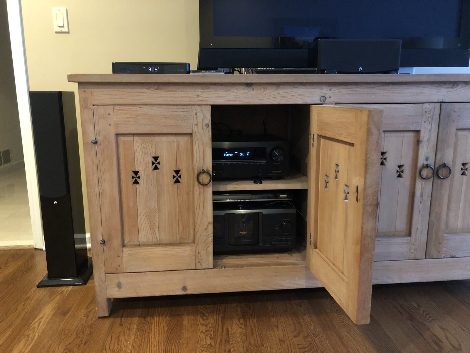

Hello Audioholics! I'm new here and I just upgraded my system with a Denon AVR-3700H. Amazing sound, but wow, does this thing get hot! I have it in a cabinet that has a lot of breathing room on top and on the sides, but with the door closed it gets really hot. I was looking at some AC Infinity Aircom fans on Amazon yesterday and was thinking of getting one that sits on top of the receiver. Was also considering adding another fan to mount on the back to ventilate (AC Infinity Airplate S3). So, I have a few questions:
1) Receiver fans: do you recommend AC Infinity? Are there other brands to consider?
2) Fan exhaust direction: I'm thinking exhaust to the rear if I do install the cabinet vent fan. Or to the top if I don't need a cabinet vent. Anything to consider for exhausting to rear vs top?
3) Cabinet Vent Fan: Do I really need one? Would seem so, otherwise the hot air just stays in there. But, what a mess that's going to make!
4) Cabinet Intake Vents: Do I need to add an intake vent, too? My cabinet has a great Southwestern design with triangular cut outs, 3 in each door and one on the side, so 7 total for this side of the cabinet (see photo). They're each about 2 x 1.5". Do you think these cut outs will provide enough airflow for intake vent? I'd really rather not have to put too many holes into this cabinet and make even more of a mess!
Thanks in advance for your input. Who knew one purchase would lead to so many questions!

If you don't mind altering the cabinet, then you could get crafty with ventilation in the cabinet itself. First, though... it's what I saw as soon as I looked at that photo:
Pull your speakers up so they are at least slightly in front of that cabinet! Please. ;)
OK.
AC Infinity Aircom T-10 is a front venting unit with Smart Controls that you can add in with no other concerns. You must keep those doors open when in use, and until it cools off or you WILL cook the electronics.
Getting Crafty:
AC Infinity also makes a lot of other cabinet cooling solutions (and rack cooling too). If you wanted to cut ventilation holes and fit grills and fans, you can.
Intake low. Exhaust high. Vent fans at each location pulling in and pushing out air respectively. You would still want something on top of the AVR to help pull fresher air up and through it, and AC Infinity has those two, along with controllers to help manage the fans. You will also need to consider perforating the shelf the AVR sits on so that fresh air intake can help the AVR.
Best solution:
Change your set up.
Wall mount the TV, get a proper open audio component shelf. You will free up some space and you will improve your soundstage since you won't have that cabinet acting as a block to your Speakers.
I sould still ventilate the AVR, but one or 2 little fans on top in an open setting is all you would need to acheive that, and they would likely not even need to run hard.
Just my 2¢.
Getting Crafty:

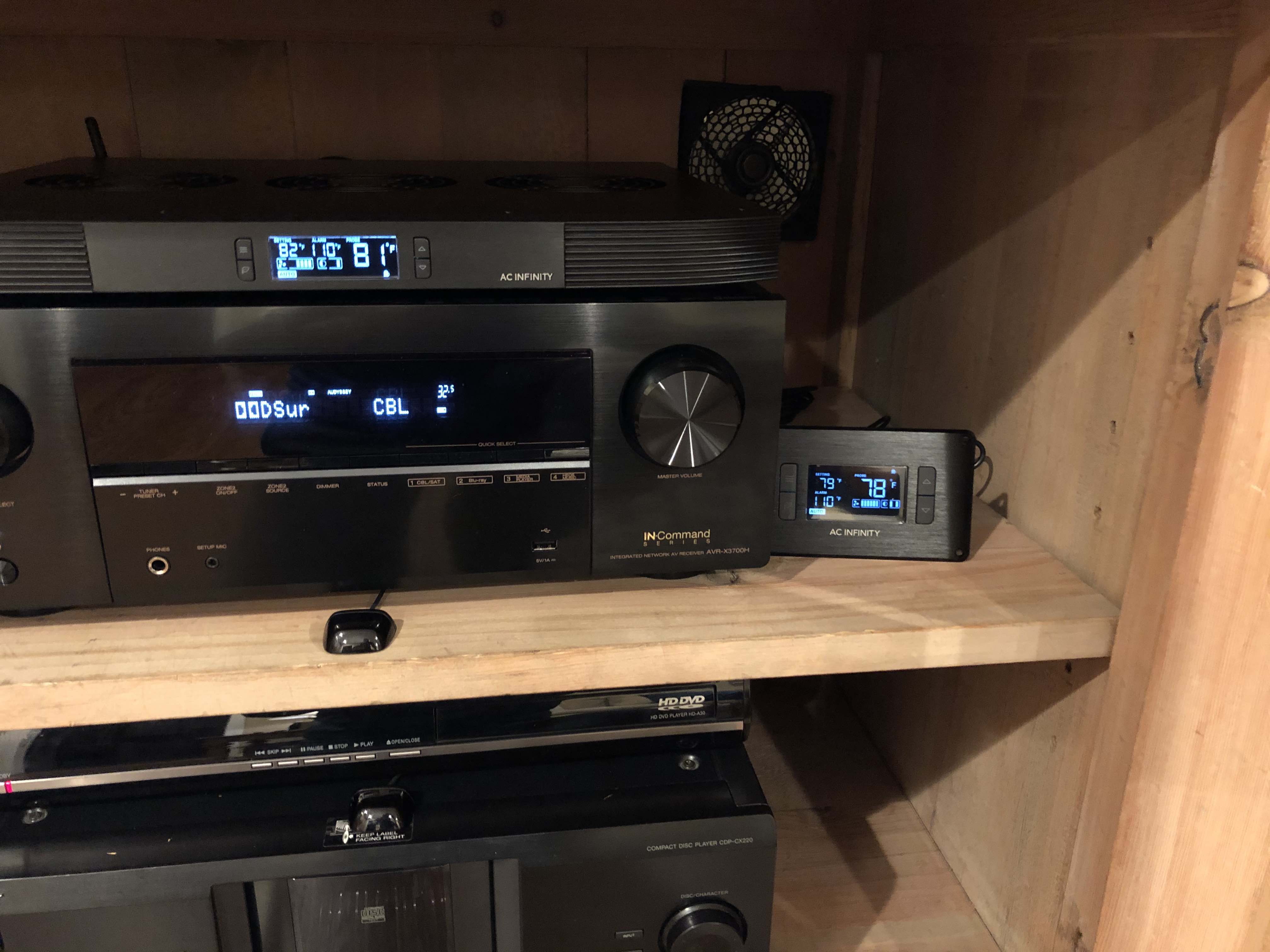

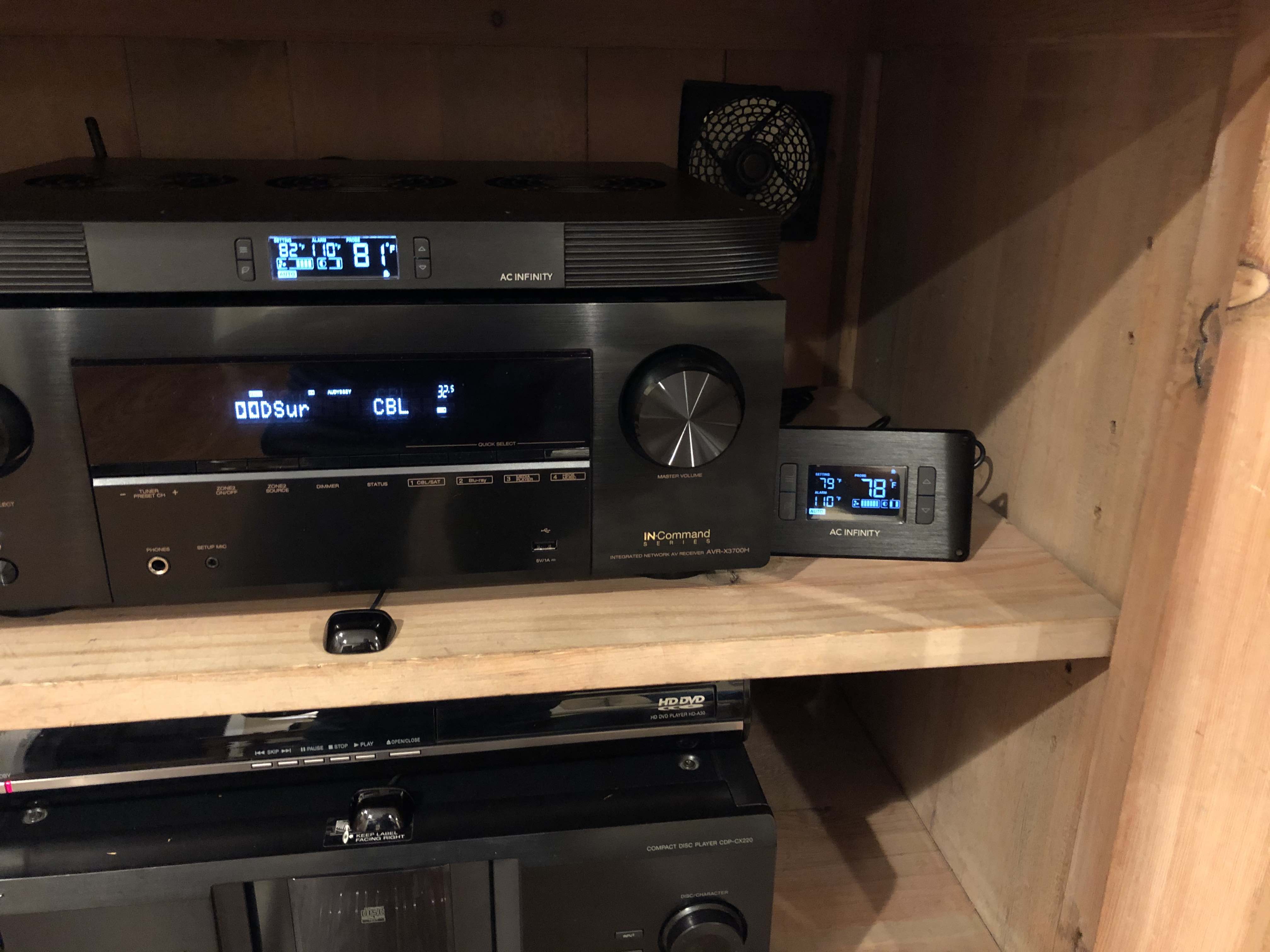

Yesterday I installed the Airplate T3, which you can see in the back right corner. Today set up the Aircom T9, top exhaust. Here are preliminary results at a moderate sound level:
Measured with T3 probe:
99 degrees: Doors closed, fans off
94: doors open, fans off
With T3 on (set at 85):
95: doors closed
91: doors open
With T9 set at 82/T3 set at 79:
81/77: doors closed
I'll have to wait until the girls go out to see how higher volumes affect temp and temp regulation, but for regular viewing, this is perfect.
Thanks all for your help!

One thing you might want to try is putting some 2x3s under the Denon to create a little more space under it. The temperatures look good but it might reduce the need for the fans a little

Ok, girls went out this afternoon and I queued up David Byrne's American Utopia from the DVR. We had seen this show in 2019 on Broadway before the pandemic and planned to go again when he circled back around to the NY area (now, maybe in 2022?). At volume level 90/100, the sound, depth, clarity, and imaging were awesome. I had to put in my larger center speaker because the smaller one was not keeping up with the other speakers and the power of the new Denon receiver.
the AC Infinity combo worked perfectly. T9 fan was set at 4 bars and 82 degrees, T3 at 1 bar and 79. Both units maintained set temperatures. I assume if T9 is set at a lower fan level it would still maintain temp, but at that volume level, who cares?!
I am really happy with the performance of this AC Infinity combo. Although it would have been great if the T3 worked on its own, that was wishful thinking. The only measurement I haven't taken is the T9 on its own. I don't think it will be any better than the T3's performance (hot) since the hot air will stay in the cabinet. But, at some point I'll check it out just for fun.
