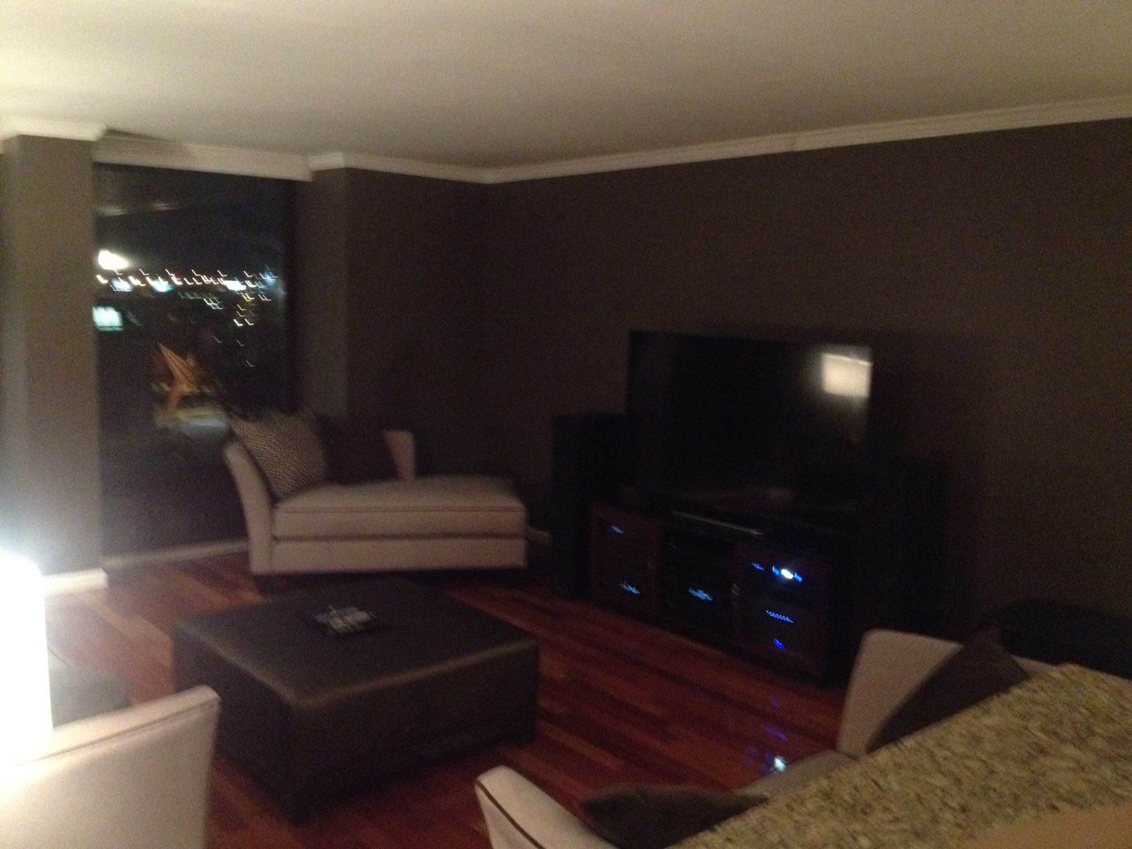

I just moved into my downtown apartment last week and already received a comment regarding my music even though I had my stereo at -30dBA. I am only renting so I need to stay within reasonable solutions when figuring out the best way to soundproof my apartment in order to reduce the sound carrying outside of my apartment.
I've added a few pics.

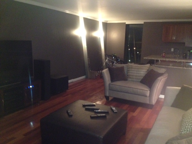

It's all a pretty much an open area. Hardwood floors are throughout. The pic with the sconces (where my bikes are currently) will contain a dining table and I have a picture planned to hang on that wall.

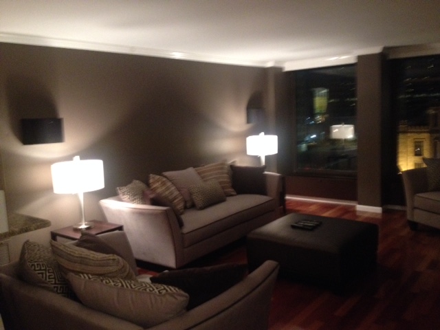

I started looking into decorative sound panels to hang above the couch but not sure where else I can place them and so not sure that above the couch will be enough. I would like to avoid having sound panels being hung throughout because that will be an eyesore and is just not practical for a general purpose space.

Forget the panels, they will not help. You should look into near-field placement, for speakers and sub. By moving either closer to the speakers or the speakers closer to you, the volume needed for the same loudness at your listening position is greatly reduced. Use the sub in a end-table type placement next to your seat, or use it right behind your seat. The bass is likely the greatest offender here. Get that sub close to you so you can turn it down while keeping the same loudness for your listening position.

You won't stop the bass easily. Sound moves in three ways- directly, through the air (radiation), structure-borne transmission (through materials and objects) and modulation sound through the air causing the structure and objects to resonate strongly enough that they radiate the sound. At -30dB, the second may not be the reason for the complaint, but the last one is probably is. Low frequencies travel a long distance in air without completely sealing the room but the floor and drywall act a bit like a drum head and you can't be sure exactly what part of a floor or wall will be the spot that causes the sound to reach the other people.
Unfortunately for you, the sub may have to sit idle until you find a different place. If you concentrate on having good mid-bass, you won't bother other people in the same building and for a lot of music and other material, it should sound very good but it won't rumble the way you might like during high-intensity action scenes, music with heavy bass or special effects.
The cost to prevent the bass from reaching the other people will be too high to make sense and if you do any construction, you'll need to get permission from the owner.

Try placing the subwoofer in the far left corner, behind the white chase lounger. Then rerun auto calibration.
