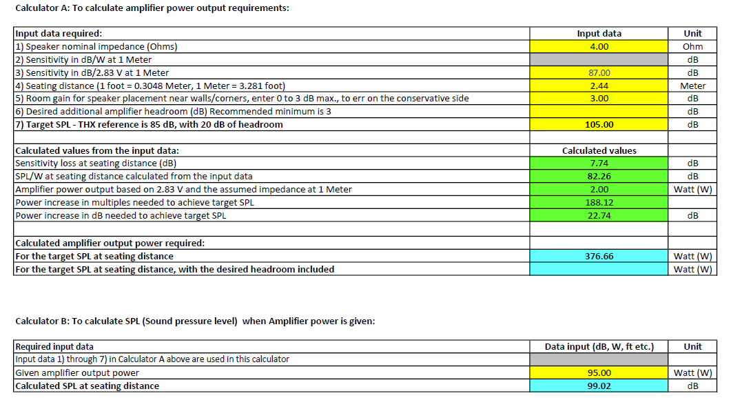

First step is to find out your power need based on the Vandersteen 3A's impedance and sensitivity specs, your seating distance, and the maximum SPL you want to have. Without that, we can only guess based on assumptions we make.
sls141
Sensitivity 87 dB, 1 meter/2.83 volt input
Impedance 6 ohms nominal 4 ohms minimum
Seating distance 8 feet
Max SPL ?
For 2 channel listening, the mood I'm in will determine how loud I think it should be at the moment. Sometimes, I want it pretty damn loud, but usually moderate levels are the norm.
For surround, I have trusted Audyssey to handle the setup for the most part. We'll see how it handles the Vandys when the time comes. I'm guessing it will want to set the Vandys to large. My Denon AVR used to set the Paradigms to large, but I would switch it to small and set the crossover to 80hz. The Marantz would set them to small and the crossover to 40 hz. There again, I went with 80hz for the crossover.

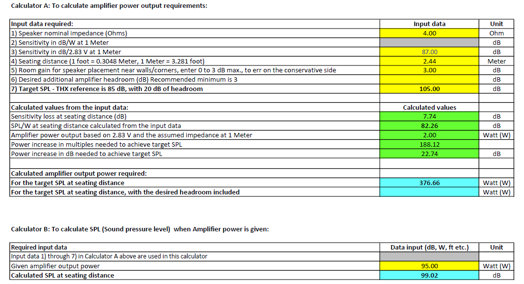

Here's my spreadsheet that shows the amp power required (377 W) for "reference" level at your mlp (8 ft):
Ref level is very loud, and the calculations were based on THX's so the SPL would be from only one speaker.
That means if you listen to stereo with two speakers, and if you are happy with 99 dB peak (should still be quite loud in your room), you would need about 50 WPC, and the SR8012 should be adequate.
I would suggest you use a separate 250 W/400 WPC 8/4 Ohm stereo power amp to drive the Vandy 3As. If you have a limited budget, a pair of Outlaw monoblocks would be a good choice imo.
By the way, those speakers can go very low, but it would be a mistake to set the crossover to below 60 Hz.

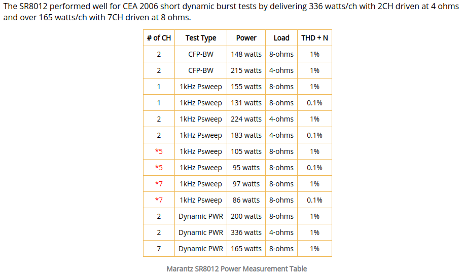

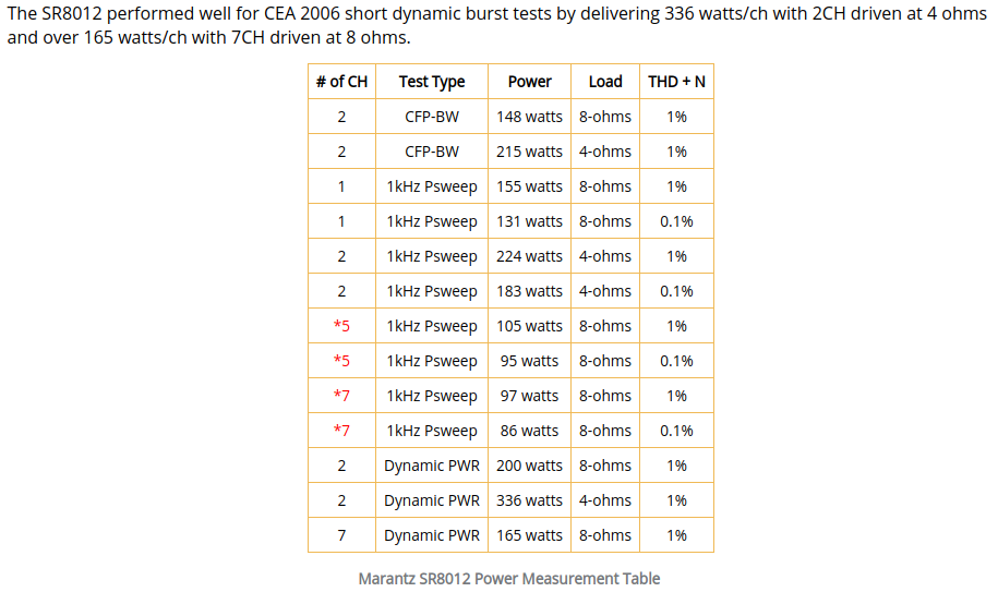

Regarding the CEA 2000 dynamic test, it is helpful in the sense that a lot of music such as classical and jazz could have up to 20 dB or even high peaks that don't last more than 20 ms +/-, but if you listen to compressed music, or live rock concerts and such, don't count on those rating.
Again, my calculator did show the SR8012 should be adequate but for me I would feel better driving them with the Outlaw Monoblocks. The Monolith amps are good too if you don't mind the weight and heat.
