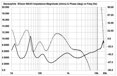

A good friend of mine has a stereo system with a pair of Wilson Maxx Speakers, AR Mono Block Amplifiers, and MIT Cables (amongst other high end gear). He's into vinyl and frankly never left it. (He's in his early 70s now and never thought CDs sounded as good as vinyl. He doses have a Mark Levinson CD/DVD player).
The problem, since new, one or the other of his AR Mono Block Amplifiers has blown up 14 times. He used to send them back through the dealer for repair until he retired and closed his doors. He then sent them to the AR Factory in the USA (Minnesota?) a couple of times. Even though he spent considerable $$ no one ever could find out what causes the failures. He dutifully warms up these Tube Amps before pushing anything through them.
I read an old Stereophile article here http://www.stereophile.com/floorloudspeakers/324/#6XcAuwTOquVAgVOx.97
which said:
Wilson claims a somewhat lower sensitivity, 92dB/W, than the X-1's 95dB. In amplifierspeak, that means a doubling of the necessary amplifier power to achieve the same effective loudness. While the X-1 offers a reasonable 8 ohm load, the new MAXX admits to a more demanding minimum of 3 ohms, which might prove too much for some tube amplifiers, even high-power ones, to bear.
Read more at http://www.stereophile.com/content/wilson-audio-specialties-maxx-loudspeaker-page-2#Xi5lywYkr7hLqjVC.99
I'm wondering if his issue may be related to this. What do you think?

What is causing the problem is difficult as this system is awash with culprits.
Lets begin with the tube amp. Acoustic Research of Annapolis Lane Plymouth Minnesota was founded by William Z Johnson in 1970. They specialize in massive vacuum tube amps among other tube products. They are now part of the McIntosh Group.
If you must have a tube amp these are among the best of them and they are an ethical company even if selling monstrously expensive tube amps, which are arguably inferior to good solid state amps. This is especially true driving difficult speaker loads as they have output transformers which don't perform well with varying impedance loads and negative phase angles between voltage and current. So if you do insist on a tube amp you have to choose your speakers with great care.
That brings me to Watt speakers. Watt are well up my list of lousy speakers to be avoided despite their high cost. I have never heard one of their speakers I like and I strongly suspect the speakers are incompetently designed.
In reference to the problem at hand, these speakers are the most likely cause of your friend's amp failures. So let us look at the impedance curve and phase angles.
There are two things that strike me.
The first is that the impedance actually drops to almost 2.0 ohms where there is a lot of power required at 250 Hz. Now I would be strongly suspicious that that reading is lower then the DC resistance of the drivers at that frequency. If that is so then the crossover is in resonance. That alone would explain your friend's difficulty.
But there is another serious problem.the phase angle is going off the bottom of the chart at 6 KHz. It is -90 degrees and still heading south. This means there is a huge gap between voltage and current phase. Now this is just the sort of thing well known to send tube amplifiers in to ultrasonic oscillation. The oscillation is well above the range of human hearing. This problem really blows up tube amps.
So we already now have two causes that could be responsible for these disasters. You absolutely have no business marketing a speaker with curves like that.
In fairness to Watt, this sort of thing is prevalent in the high end exotic speaker market. This was addressed by Dr Floyd Toole in these forums in the recent past. He specifically called them "incompetently designed speakers requiring arc welder amps!" This does not excuse Watt though.
Exotic powerful speakers are not well served by passive crossovers and are much better served by electronic crossovers with multiple power amps. I use three amps per speaker in my reference design.

Tube amps can drive a low impedance, but the output transformer must be wound to handle this.
Ask him if he disconnects the speaker cables from either end when the amplifiers are powered- this is a big problem for tube amps and should NEVER be done.
Has he ever mentioned what fails in these amps?

Yes, but what do you wind it for? That impedance curve is all over the map. I now notice something I had not noted before. I noted the phase angle heading south, at 6 K and disappearing. Now I note it reappears, and heads above +90 at 12 K and back down to -20 by 20 K. There is something really rogue with that speaker design in the last two top octaves. That is just the ticket for blowing up a lot of tube amps. As I think about it this is likely the cause of these repeated catastrophes.
This is a common problem with electrostatic speakers and tube amps. When Peter Walker produced the first ESL speaker back in the fifties, he had to design his Quad II tube amps to be unconditionally stable. I well remember that those speakers blew up his major amp competitors products, which at that time was Harold J. Leak. His amps went totally unstable.
Ideally, it would be wound for the expected impedance range and then, choose speakers that don't operate outside of that parameter, which those clearly don't. But then, this isn't a musical instrument amplifier, it's a HiFi amp, which will undoubtedly be used for speakers that DO NOT match the amplifier.
If those speakers weren't difficult to drive, Wilson wouldn't be able to challenge anyone to make amplifiers that are up to the task, would they? Personally, I think that's a stupid way to operate. If they want their speakers to be driven by a welder, they should sell the speakers WITH one, as a matched system. That way, people won't be surprised when they go out of business.
It is not just being difficult to drive. That drive difficulty indicates a serious problem. Even if you drive them with an amp they don't blow up, they still won't be good speakers.
