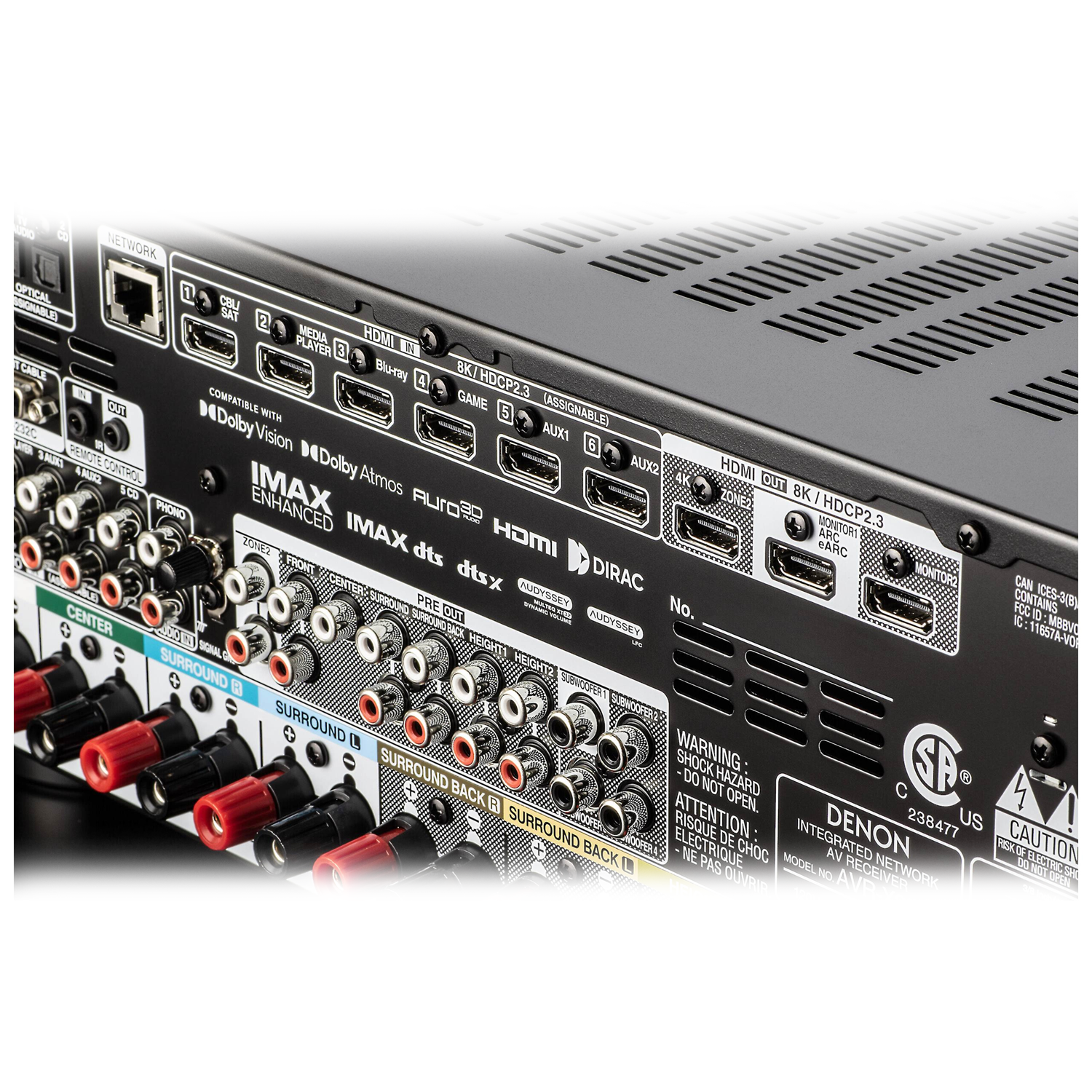

The boys are correct. First Denon model with full pre-outs appears to be the X3800H which Accessories4Less has for $1,099. Might take some digging to find a used unit with full pre-outs. Note that it is not Zone 2 that you want. You want a full set of pre-amp out jacks like below (back of 3800H). The Zone 2 feature allows you to power a second pair of speakers in another location.

Oh man yeah that's a lot. Maybe I'll look into fixing my receiver. It turns on it's just no audio. Damn this is disappointing. Now I understand what to look for so I'll keep an eye out but not getting my hopes up. I guess I'll just stick to the JBL 710 for now.
