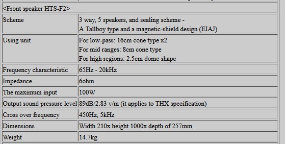

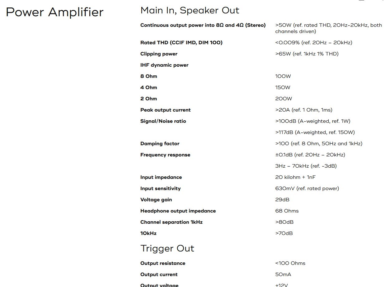

i always listen to songs or watch movies on my computer. just recently some one gave me a nad c326bee amplifier . i bought these old onkyo thx certified hts f2 front speakers and hooked them to the amp. after i play 4 or 5 songs the cabinet of the amp starts heating up . it get very hot. i asked the person who gave me the amp if the amp got heated at his place but he said no . he said may be the speakers are not matching. im just a novice. the amp i think is rated for 8 ohms and 4 ohms while the speakers are 6 ohms. is the amp heating up during use because the speakers are not matching. i searched the net and got the spec sheet of the speaker . attaching it to this tread.i have also attached spec sheet of nad c 326bee amp also . pls help.
PENG
i always listen to songs or watch movies on my computer. just recently some one gave me a nad c326bee amplifier . i bought these old onkyo thx certified hts f2 front speakers and hooked them to the amp. after i play 4 or 5 songs the cabinet of the amp starts heating up . it get very hot. i asked the person who gave me the amp if the amp got heated at his place but he said no . he said may be the speakers are not matching. im just a novice. the amp i think is rated for 8 ohms and 4 ohms while the speakers are 6 ohms. is the amp heating up during use because the speakers are not matching. i searched the net and got the spec sheet of the speaker which is in german language . attaching it to this tread. pls help.

Once you got that figure out, you will get the answer as you already know the C326BEE is just a nice little integrated amp rated for 50 W into 4 Ohms but obviously more on short term basis.

While an amp can normally get warm it may get a lot warmer if you're using it at high output levels. Ventilation counts, too (or adding a fan if worried). The amp is rated for 4 ohm (and even has 2 ohm dynamic ratings) but isn't particularly powerful. @PENG beat me to most of it :)

But to what levels are you driving it? Do you have an spl meter app in your phone you can give us an idea at what your listening level is and at what distance from the speakers? On the face of it, the speakers aren't particularly an issue for the amp's rating. Used gear of course might have issues.....
