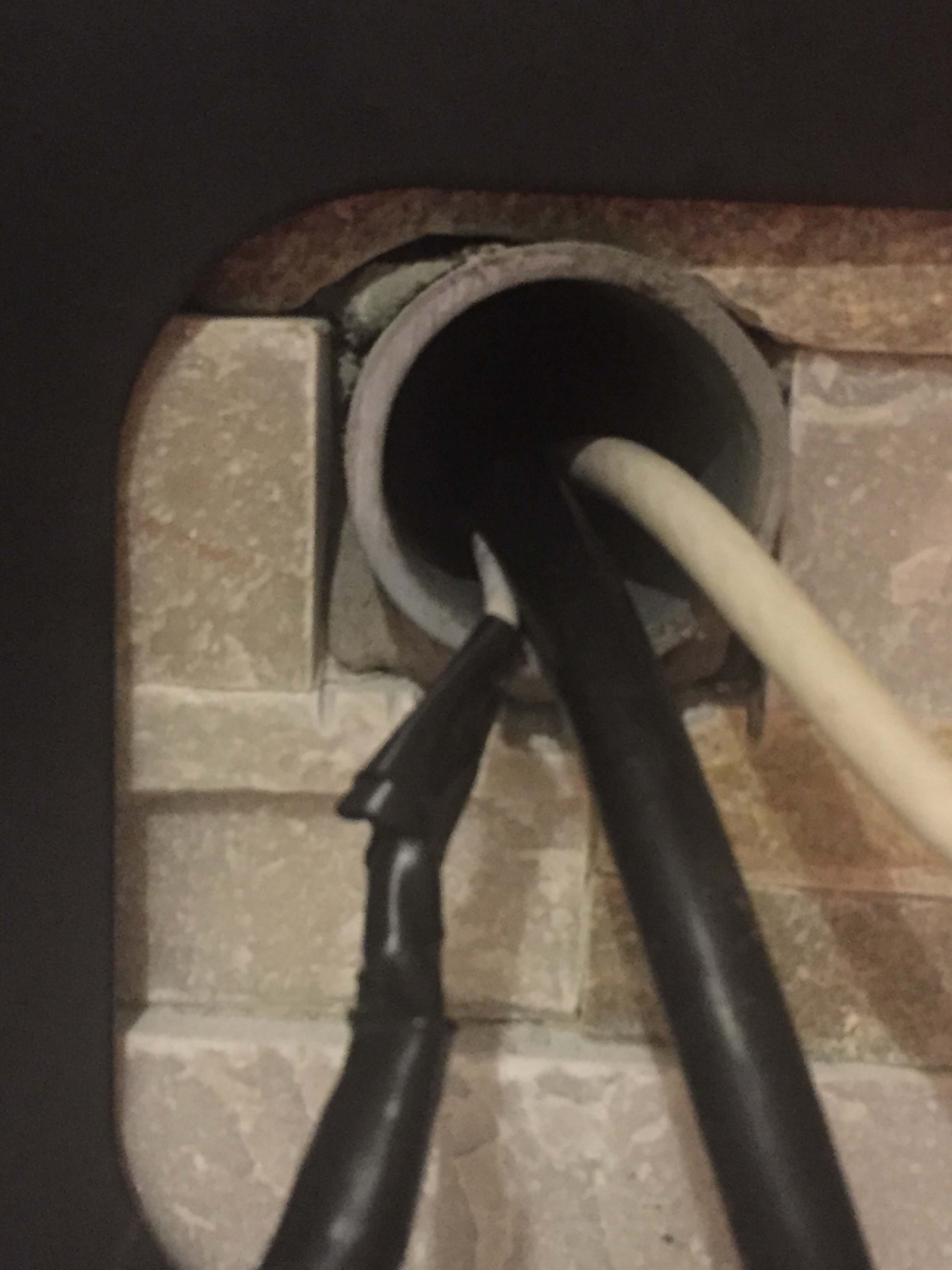

I'm moving into my new place and the previous owner installed speakers on both the wall where TV is mounted, and sound bar. Additionally, they installed two speakers on the ceiling. All of these cables run to a central hub about 20 feet away. I know it is a 5.1 system, as that is what he informed me. I have two questions, are there any receivers that you recommend? I will be running a DVR, Nvidia Shield and PS4 off of the receiver hoping to pair with it to play music as well.
Secondly, there was 1 IR Blaster on the TV this spans the 20 ft to the central hub, then it becomes all exposed wires....and there is no receiver. Has anyone come into this before? Let me know if pictures are helpful.

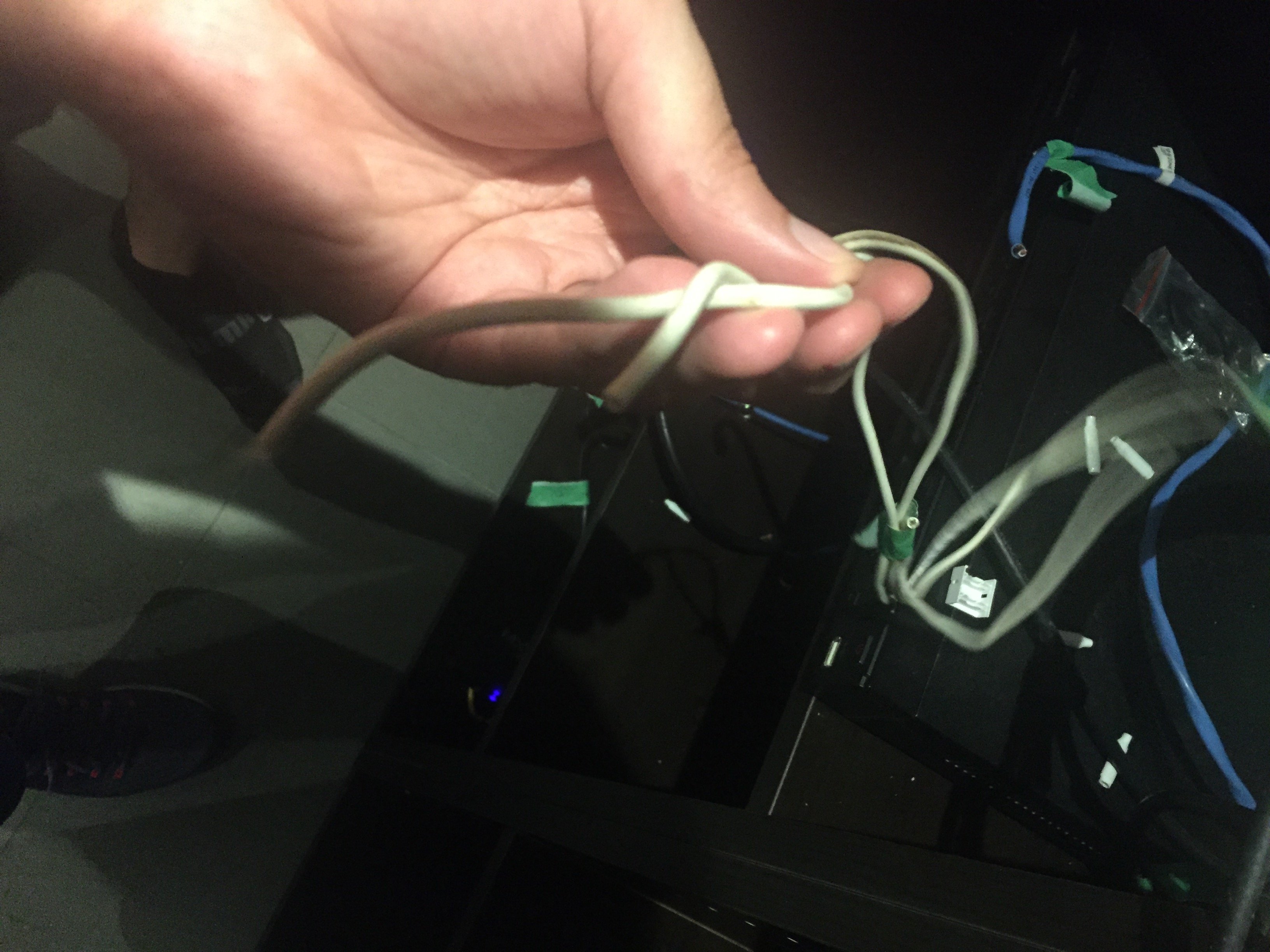

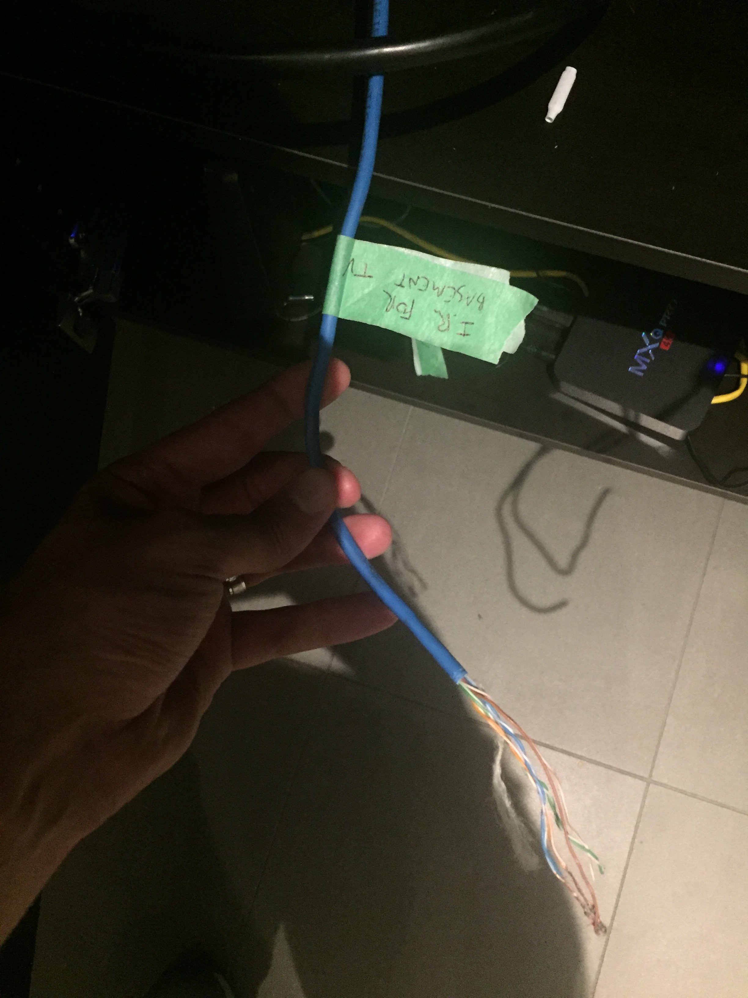

The IR Blaster - this is the wiring - it is quite confusing. I am completely lost on how/where I would plug this into. No Receiver was left. Also the grey wire coming out of the pipe is the TV side, there is a blue CAT5 that says TV IR Blaster and then those separate grey wires look like they are coming from the same area.

I really cant see the other wires clearly but it looks like the ran the cat5 for the ir blaster. This means you need to terminate the end (reciver) where the tv is and make the terminations at the head in to the block and the ir flashers attach to it. Here is a video that will give you an idea what I'm talking about
You just need to purchase the ir repeater kit. There are many available.

Thanks! Okay starting to understand. The cat 5 is terminated at the TV. It’s attaches to the IR Blaster.
This cat 5 goes back to the central console. So if I wire this to the IR receiver I should be fine. But does that mean I can only use this for one device?

Should be good from 4 to 8 devices. Your only going to use a couple of strands from the reciever to the block and depending on the block attach either single or dual flashers to each output on the block. Always run your flashers on the top of components, that way for if they come loose they dont fall down and still flash the component. I use a dab of hot glue to attach them.
