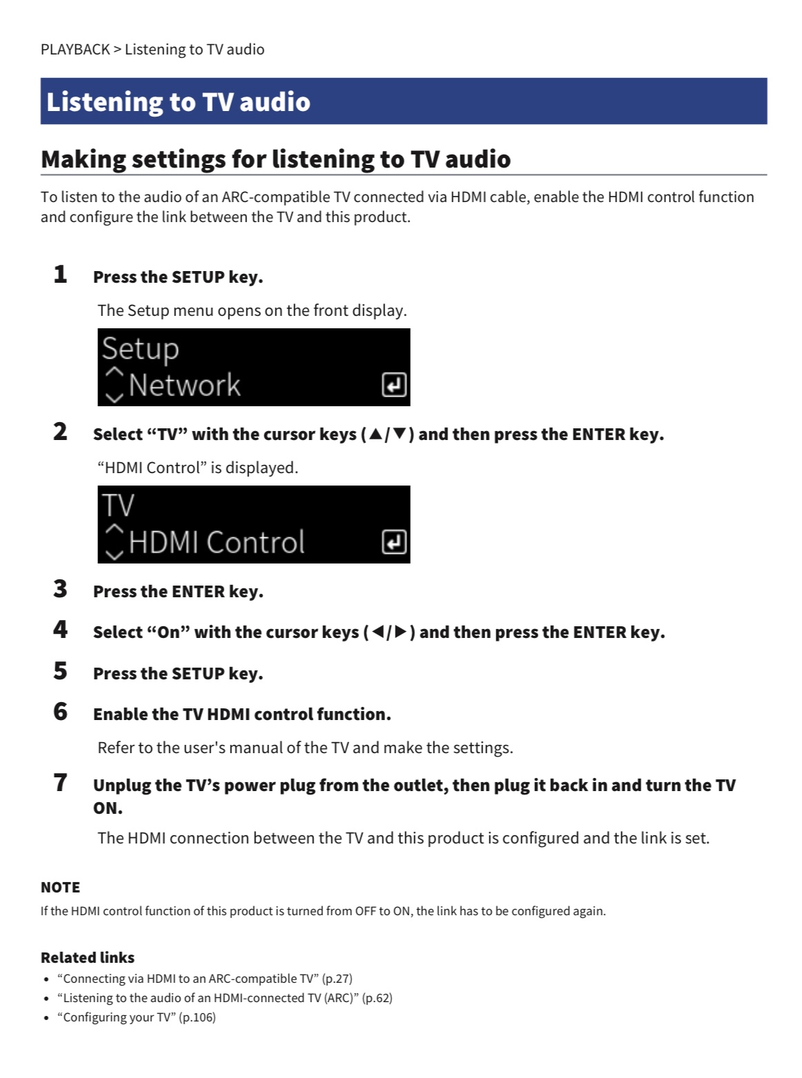

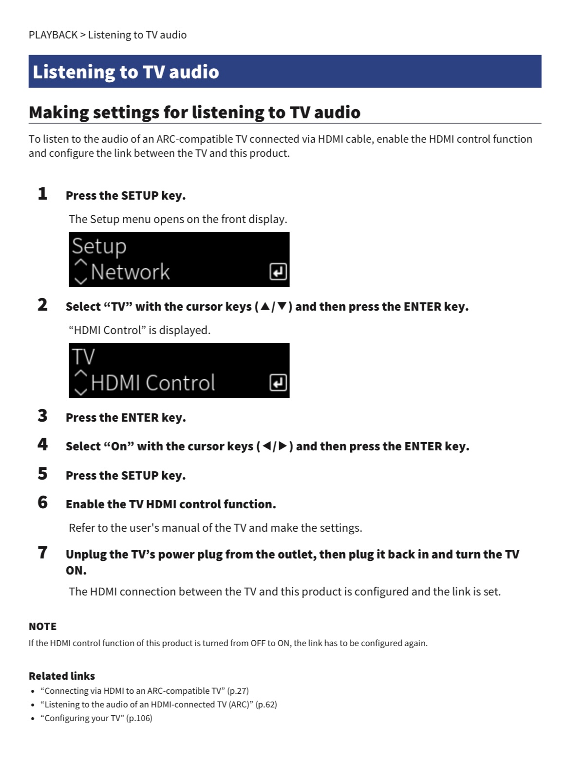

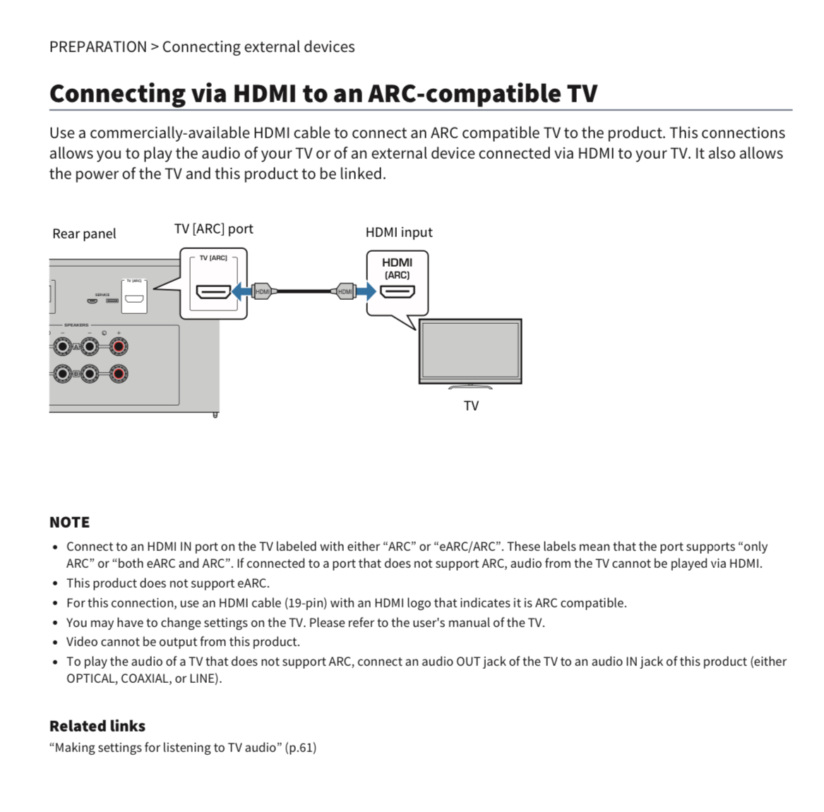

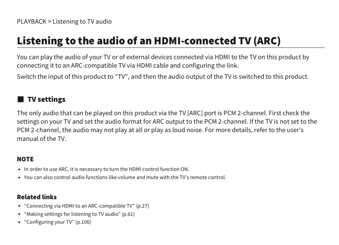

If I may add a correction, the R-N1000A does NOT support eARC, but rather ARC. It can only be connected to a TV supporting ARC/eARC and can NOT be directly connected to a disc player or streaming device. Because ARC is dependent on HDMI-CEC to function, HDMI Control must be turned on in the unit for it to work.
TVs supporting eARC must have it turned OFF and use ARC as the increased bandwidth out of eARC will not work over ARC. The TV, and any devices connected directly to it, as well as devices connected to the unit using optical or coaxial digital connections must be set to output PCM 2ch signals as the R-N1000A does NOT support DSD, Dolby or DTS signals from those particular digital ports. Though, DSD is supported over MusicCast and USB connection.
View attachment 65644View attachment 65646
You are correct. I'm so used to reviewing multi-ch AVRs that I mistakenly wrote eARC instead of ARC. The review has been updated. thanks

For the amp only having ARC instead of eARC: I wonder how much difference it would make since it can only accept 2 channels of input anyway. At the same time, others mention that "If you only want [2 channel] sound from the TV... ", but today's TVs regularly put out multi-channel and ATMOS via eARC -- so connecting this amp to the TV would eliminate all that. But then, that's where eARC could really come in: attach the peripherals (Apple TV, etc.) to the amp and then send the video to the TV -- but with only ARC then, wouldn't the video be limited --- or am I conflating ARC with the limitations of HDMI 1.4?

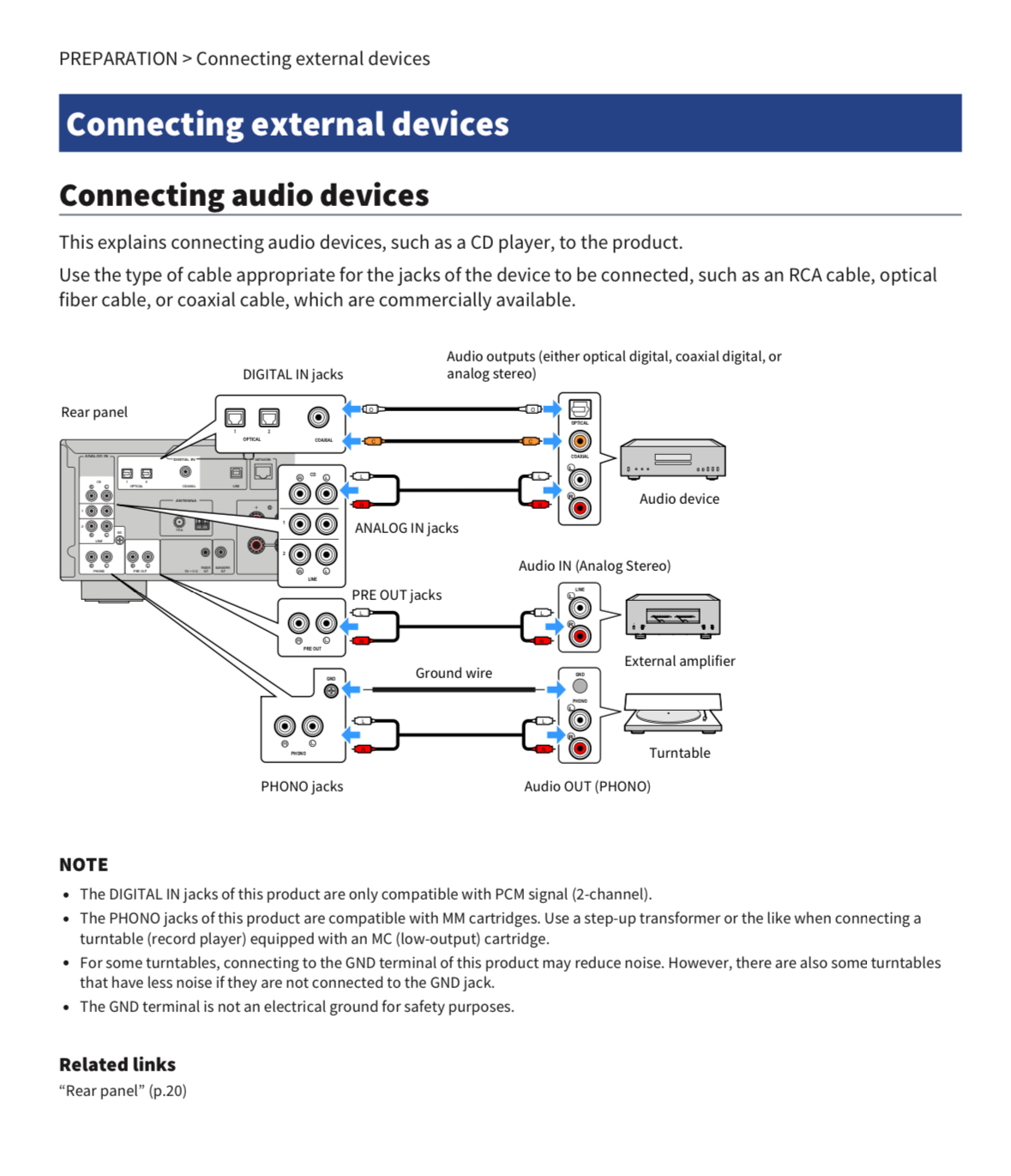

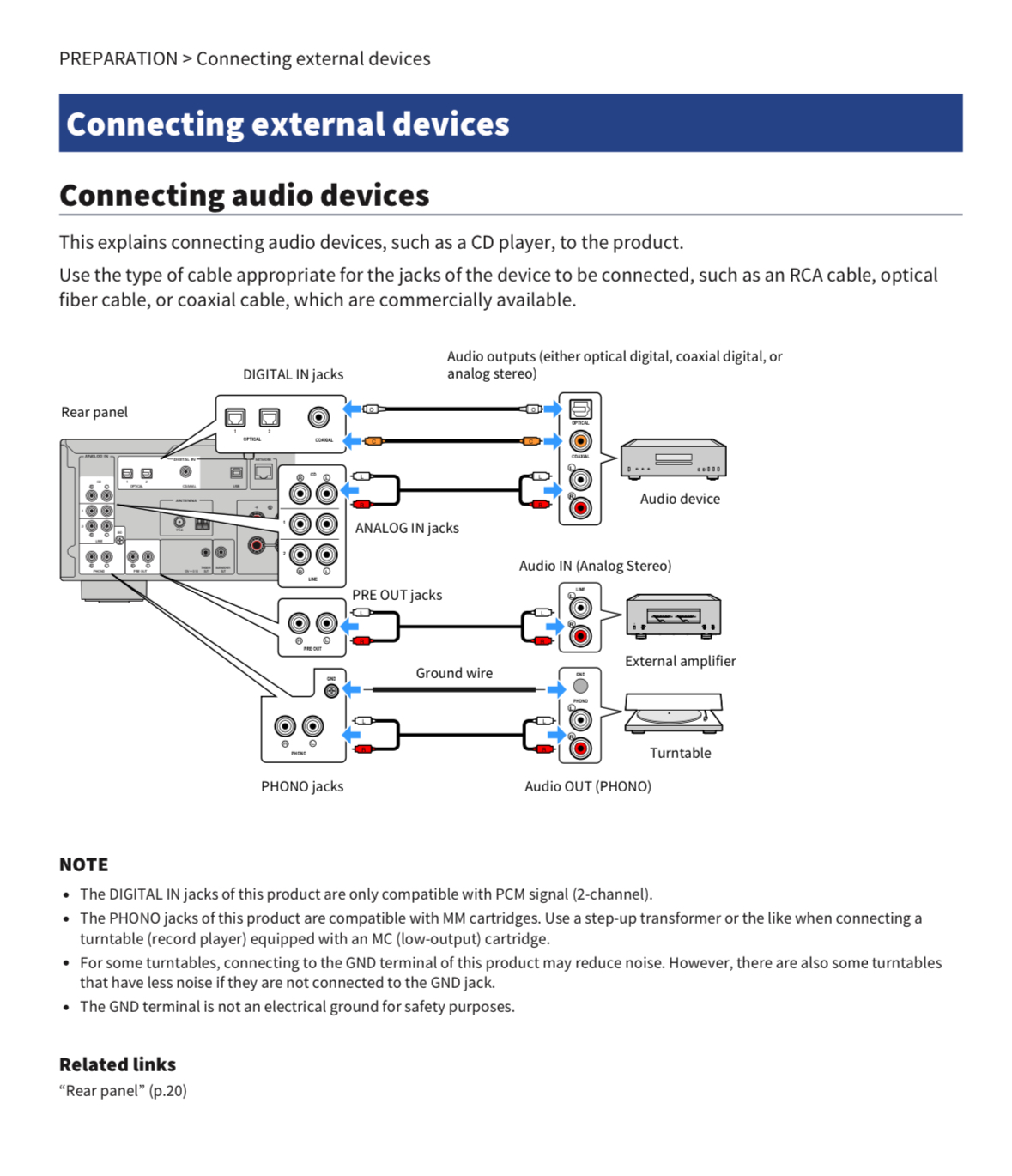

Trebdp83
There are no HDMI inputs other than the ARC port here. It’s a 2ch PCM affair from the ARC, coaxial and optical ports. TVs and devices connected to them should all be configured for 2ch PCM/Stereo output to avoid audio signal output issues.
Because ARC requires HDMI-CEC to work, certain TV commands will switch the integrated’s source input to ARC. This can be an annoyance. Better an eARC port that can work without HDMI-CEC being ON.

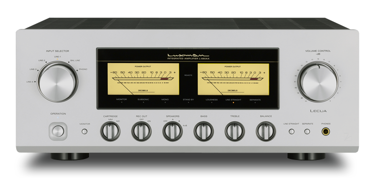

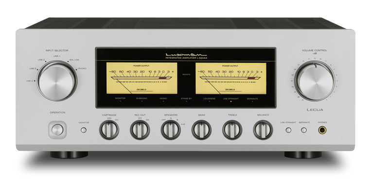

I wouldn't mind seeing a review of the JBL integrated amp- 120W/ch @8 Ohms, 220W/ch @4 Ohms, it has more inputs that many and it has pre-out. Spec sheet is pretty weak, though.
That does look pretty cool.
These cost too much for me. But if I were to get an integrated amp, it would have to look very cool and have great network streaming.
