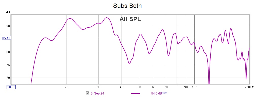

Before Audyssey.

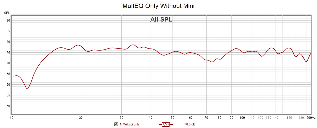

After running Audyssey.
Can you honestly say that it made things worse or had no positive effect at all??

The question I have to ask, is does it make any difference, or make it worse? So you have five significant room nulls below 200 Hz. All are pretty low Q, and in that frequency range probably not audible. However to cancel them, you are adding a lot of boost, and really stressing drivers, and amps. There is a widespread school of thought that you should NOT aggressively treat nulls like that, only shave peaks.
I guess if that is truly accurate, why do you have so many nulls? I really don't have nulls like that in any of my three rooms.
However it is in the sensitive mid band that I have issues with Audyssey, and also on the high end. From that nasty cheap plastic mic, powered from the same wires as the signal, totally contrary to accepted practice, it concocts curves that I know to be pure fiction. Then applies correction to produce a nice curve that does not sound anything like reality. In addition it corrects for the falling HF response of the reflected secondary signals. That probably contributes to the significant degradation of the S/N ratio. With Audyssey engaged I hear hiss in all my systems at the listening position, whereas without it, the systems are silent at the listening position.
There is a lot of fanciful and bogus concepts involving this program. At the end of the day, it sounds bad.

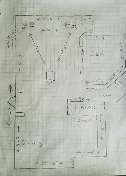

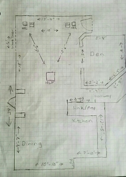

Why do I have nulls..? Well I would say my room sucks. I have no control over that outside of trying different placement, which I did, and it just so happens that right up front by my speakers is about as good as it gets.
I have a huge space, well over 5000³' and openings to other areas. It doesn't help that my main seating is more or less in the middle of the room. I can't do anything about that either, unless I move mlp all the way out into my dining room. If you have some advice I'm more than open to it tho. This is what my room layout looks like...

Also, it's not just boosting nulls. It's cutting peaks moreso as well as making phase adjustments, and when the peaks are cut down those nulls don't look nearly as bad.

I agree, that room is a bit of a horror show. You really do not have a better placement for those speakers. It just goes to confirm that few homes are audio friendly.
Pogre
Pogre
You know, I wasn't nearly as into this hobby when we bought our house and didn't even have hifi on my radar. If I were to do it over I would definitely take room size and dimensions into consideration.
I have off and on considered maybe putting a door in the entry to my den. Eliminating that big chamber off to the side would definitely change things.
