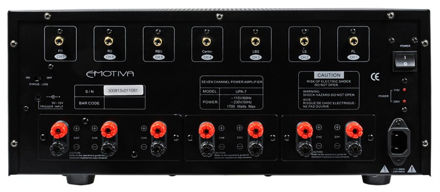

I think you mean the Emotiva UPA-7. The XPA-7 had balanced inputs and different speaker binding posts. I believe the XPA-7 GENII updated the RCAs connectors as well.
UPA-7:
XPA-7:
Although an XPA-5 Gen II, you can see the different RCA connectors:
UPA-7:
XPA-7:
