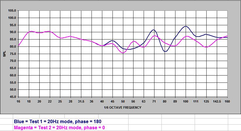

Well, the frequency response isn't completely flat, and with Slow response I might get fluctuating values in a certain 1-3dB range. The bass level is a bit different for each of the 5 channels too, so I tried to average the left and right channels. It could be 2-3dB hot or cold depending on the frequency, but with the meter averaging it out right now, it's about even to 1-2dB hot with the left/right mains.
I could run the center channel at 100Hz instead of 80Hz - it gives a flatter response that way. But with male voices in video, I was getting some chesty sound from the sub that went away by lowering it back to 80Hz.
But I've attached a graph at 1/6 octave of 0 and 180 degree phase settings on the sub, with the sub in a slightly different position than it resides now. But it's tones from 160Hz to 16Hz, 1/6 octave, running through the mains and the sub.

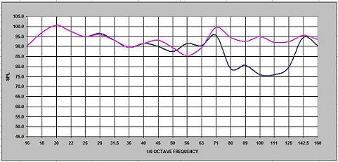

I spent some more time tweaking my speakers' positions last night.
With different positions for the speakers, the interaction with the sub also has changed dramatically. I re-ran 1/6 octave tests in phase 0/180, and came up with what is in the attached image.
Phase 0 seems to be flatter, have less variation (and easier to calibrate), so I've gone with that for the time being. I'll see if I keep my speakers in the same spots, but I plan on getting room treatments pretty soon, so that will drastically change the sound too.
