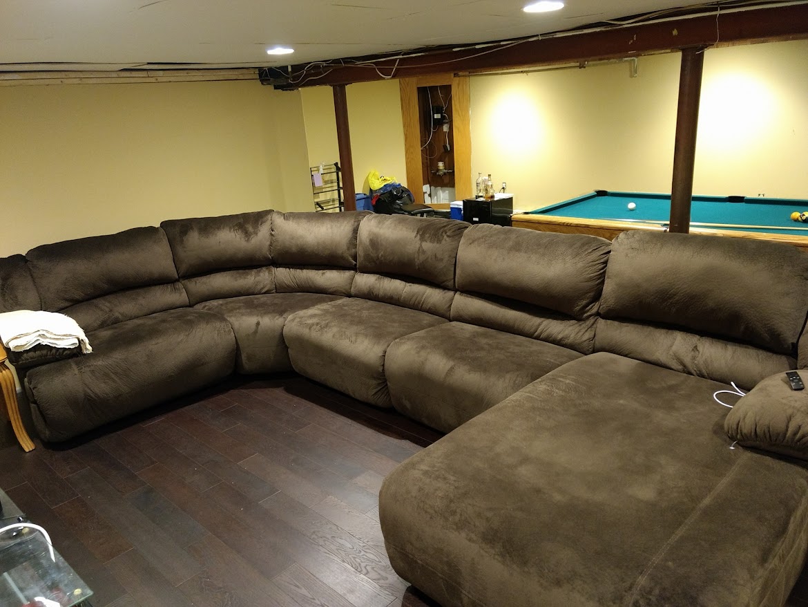

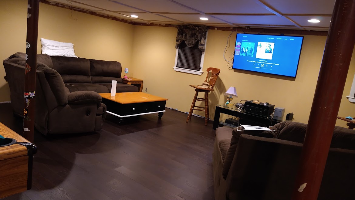

Appreciate input. I just finally after years have all the pieces to start. (I think) room is not great. Basically working with my finished basement. Only using half. So 20’ wide. 11’6” deep. Tv is mounted off center of room due to window locations. Rears will need to be mounted on beam at 6’ high. Definitely could use help with exact placement. Should be 7.1. I was thinking of mounting sides from ceiling aiming down angle. Ceiling only 6’8” high. Hopefully pictures post. My 1st night on forum.

LOL most of us use rooms twisted to multi uses, eh? I tend to like working with the length rather than width of a room for layout.....but not always possible in all rooms.
So just basic 7.1 layer? No Atmos? The off center tv would drive some of us a bit nutty with OCD but.... :) Having surrounds, as well as rear surrounds, above ear level is what I generally have done, and aimed as necessary. I don't have Atmos setups (don't want to do the ceilings....). I'd start off at the Dolby suggestions for speaker layouts to get my basic ideas down https://www.dolby.com/about/support/guide/speaker-setup-guides/7.1-virtual-speakers-setup-guide/
Windows and fireplaces....always getting in the way (unless you block them out and cover them perhaps).

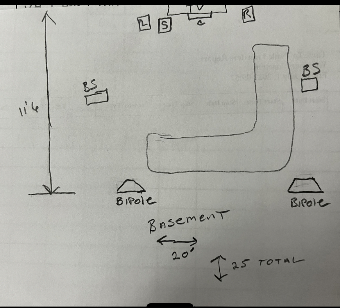

My AVR doesn’t support Atmos. Yamaha RXA800. I’ll check out what dolby suggest. Thanks for link
Kinda see what I have to work with. The wood ceiling is done now and that steel beam in middle of ceiling is now boxed in. I was mounting rears to it over couch.
