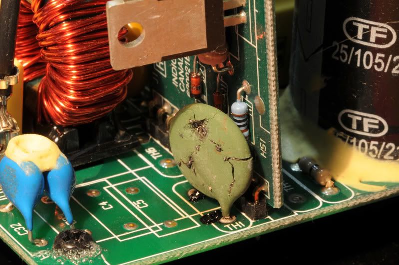

Got done enjoying MI - Ghost Protocol last night, went to shut down the Ultra and realized the little green light wasn't on :eek: it was to late to screw with, so I unplugged it and waited till this morning. Plugged it back in this AM and flipped the switch, green light comes on for maybe a half a second then turns off...repeat - same thing. This is a BASH amp that replaced the original one around a year ago after just under 3 years of service and under warranty, this one however is not. Called SVS, probably amp again, and not fuse, seeing how it tries to power up, although very briefly. So it looks like I'll be getting the new Sledge :) this time around, as soon as I fork up $399! :eek: ...any thoughts?

I'm pretty sure it must of been towards the end because of explosions and such. There was some confusion with SVS if the replacement amp was under warranty or not, one said yes, another no. Turned out it isn't, but I order the Sledge :D and should have it by Tuesday I hope. May have to re-watch MI then. SO anyone wanna buy a slightly use "AS IS" BASH amp? :rolleyes:

The $399 price is with a $200 discount for being a customer and buying replacement amp. The confusion was if the replacement amp (replacing the original under warranty) was or wasn't itself under a 'new' warranty, it was not, as it was a replacement amp. The new Sledge will have a 5 yr warranty however! So that is a good thing.

Sorry you are having problems with that amp. How old is your replacement BASH amp? If you purchased the replacement amp out of warranty, it will carry its own a 3 year warranty. If it was replaced at N/C under the original warranty, then it would be tied to the original warranty period.

The (this) amp replaced the original under warranty, it was a 'swap out', since it was a replacement amp, and the Ultra is now no longer under warranty so this one carries no warranty.

OK - got it. Contact us at custservice@svsound.com to discuss replacing that amp with a Sledge STA-1000D. I might also be able to get that component value for you - looking into it. It's not SMT so it might be a pretty easy swap out. No guarantees it will fix the amp, but it might be worth a try.
