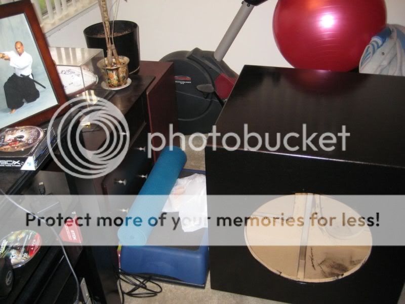

The cherry box in the upper left corner with the plant on it is the old sub. The new one is WAY bigger! Yikes.

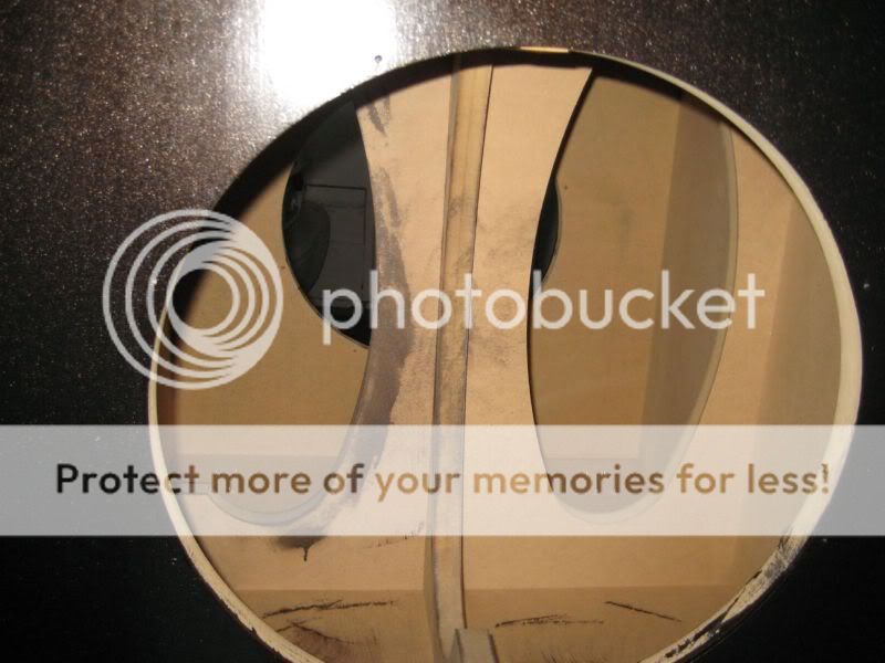

Braces

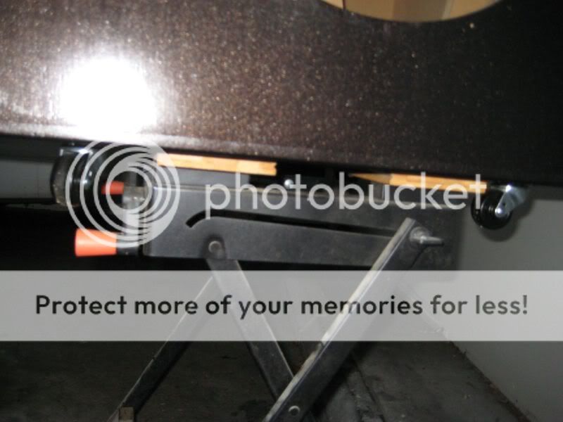

I put wheels on the bottom because this monster is going to weigh about 200 lbs when I get the woofer mounted.

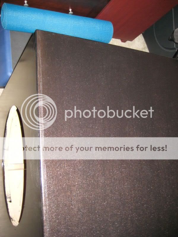

Close up of the finish. This is after 2 coats of paint.

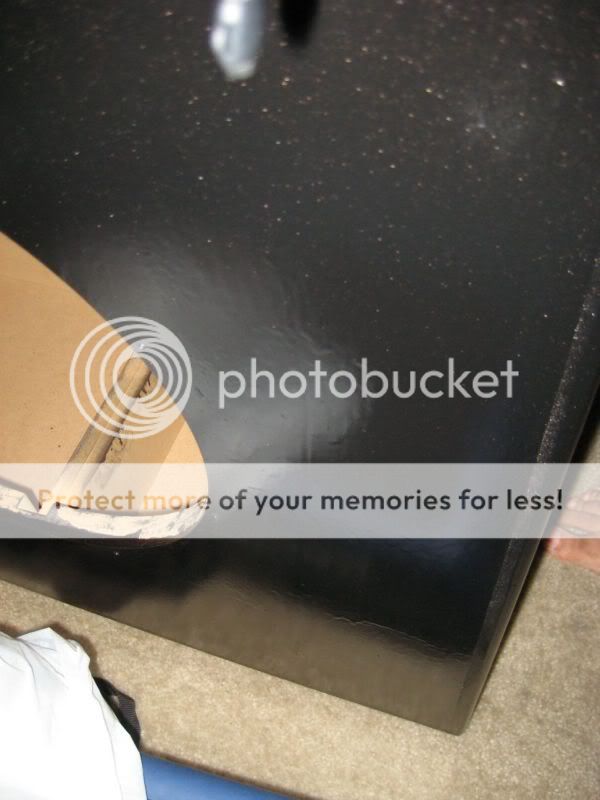

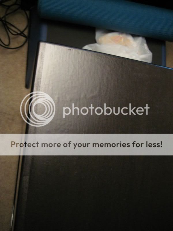

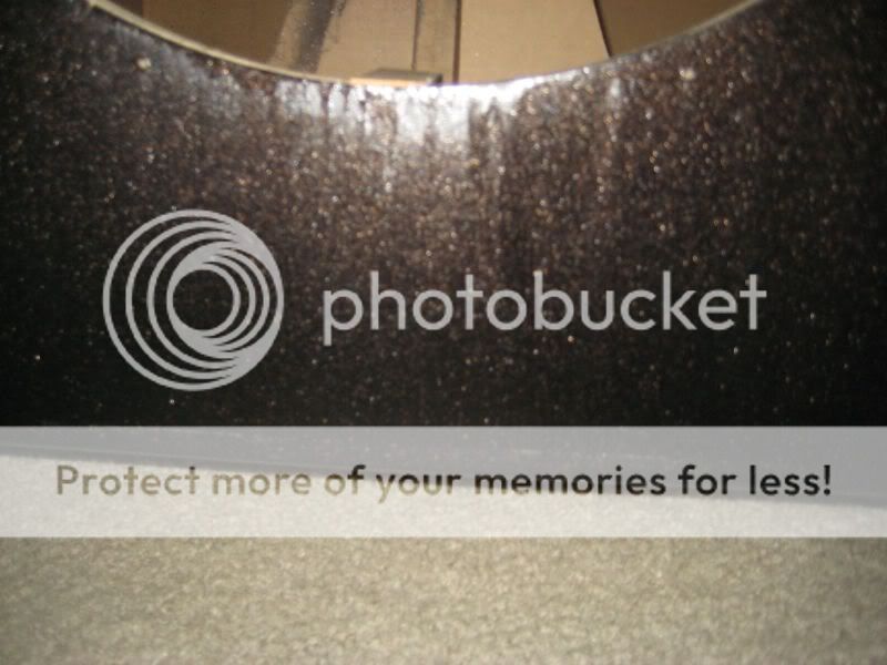

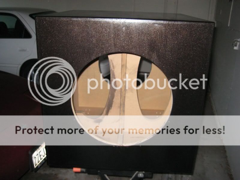

These next few pics are to show some of the imperfections in the paint job. This was my first time painting something of this size with a paint brush. Usually I just spray paint stuff. I've got some streaks and some areas that aren't so smooth. I'm tempted to hit it with one more coat of paint to see if I can smooth these areas out. But I'm planning on hitting it with a couple of coats of satin varnish tonight. I'm wondering if the varnish will help to hide some of the imperfections?
Also, I'm supposed to lightly sand in between coats of varnish right?
Streaks below woofer hole.
Bubbly area
Should I even bother with trying to give it another coat of paint? After all it's just a sub and it's probably going to go behind the couch anyway.

Yesterday I decided I was tired of messing with the thing and just decided to move on to the varnish. I put on a coat using a cheap brush I had bought at Home Depot. I shouldn't have done this. I found 3 hairs in the varnish. Luckily they were all on the back side so I didn't really care. While the first coat was drying, I went back to Home Depot and bought some foam brushes.
I waited about 3 hours and then lightly sanded the first coat of varnish with 320 grit sand paper and applied a second coat. The foam brush was MUCH easier to use. I let the second coat dry overnight and I will be applying 2 more coats tonight. Then I will finally be done.

When you say varnish I assume you mean poly urethane. I don't think you're suppose to go beyond a 220 grit sand paper as additional coats need the grooves to adhere to. Clean the sanded coat with mineral spirits and wipe with a tack cloth before re-coating. I thought you needed to wait 24 hours between coats but I'm sure you read the instructions ... right? :)

I used 320 because it just seemed so anti-intuitive to sand in between coats. I realize that you need to scratch the surface of the varnish up, but I'm trying to build up layers of varnish, why sould I want to scrape it off? I'm pretty much a noob at this stuff, but I read lots of stuff online. Unfortunately it seems like everyone has a different method of varnishing. "Thin out the first coat with mineral spirits, let the first coat dry overnight before putting more on, varnish against the grain, varnish with the grain", geez it was making my head spin. :rolleyes:
The can said that you could sand after 3 or 4 hours.

I'm actually pretty happy with how the finish turned out. I probably should have sanded the paint down a little smoother before varnishing, but oh well.
