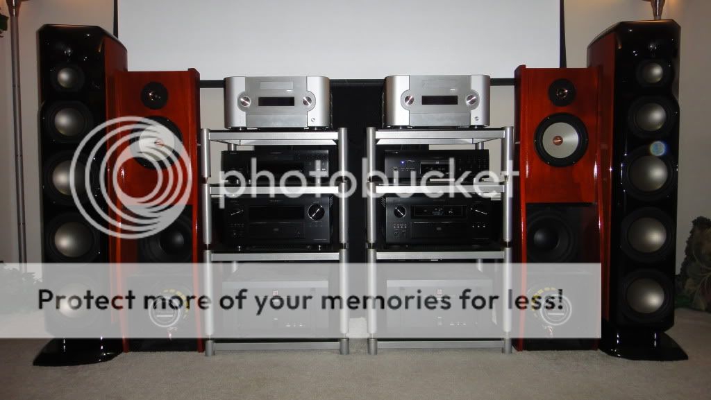

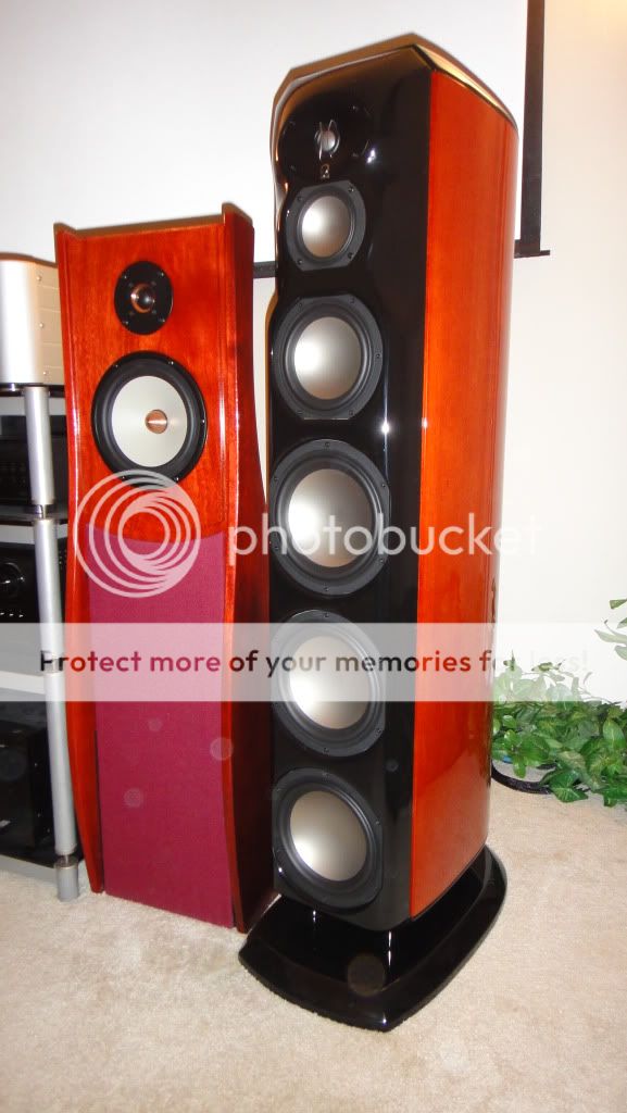

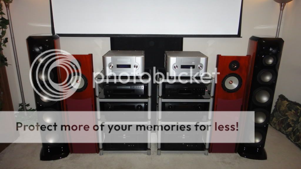

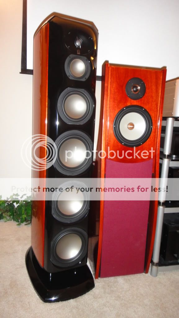

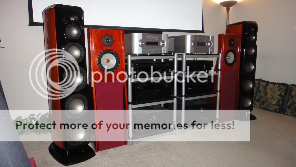

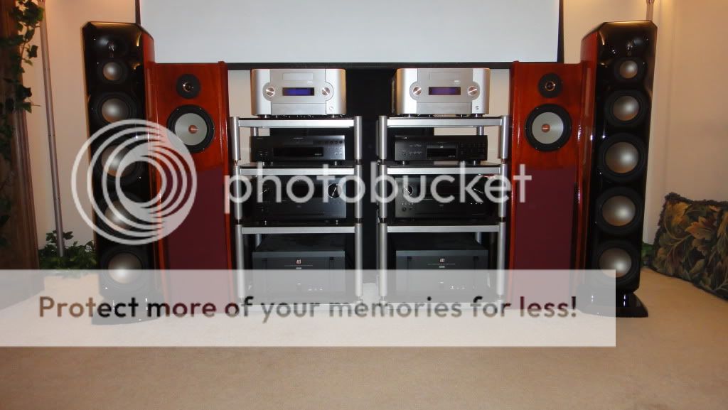

Salon 2 + Denon AVR-5308 Pure Direct

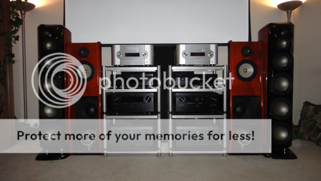

PENG asked me to see how the Salon 2s would sound with just the Denon 5308 AVR - no ext amp.
Level matched to 85dBA Max, I compared "Hotel California" between the 5308 vs. AVP-A1/AT3005. On both the Denon 5308 & AVP-A1, the volume knob was @ -13dB.
The song sounded identical to me.
I could not tell the difference.
Although the AT3005 could produce 300+ watts into 8ohm, I doubt that it was producing > 150 watts. I also played the AVP/AT3005 for 2 hours straight before doing the switch, and the AT3005 wasn't even warm to the touch.
The Denon 5308 could produce 235 watts into 8 ohms (2 ch driven, 1% THD, Home Theater Mag).
I also paused the song on the Denon 4010UD, turned the volume knob on the Denon 5308 & AVP-A1 to +18dB, placed my ear on the tweeter & midrange drivers, and listened for any hissing sound. I could not hear any hiss whatsoever.
So in conclusion, I could not tell the difference between the Denon AVR-5308 vs. the Denon AVP-A1/AT3005 when both were driving the Salon2s in 2.0 Pure Direct mode.
