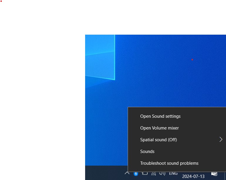

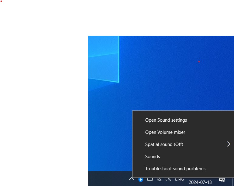

Before you connect the HDMI cable to the Dell if you "right click" on the speaker icon in the bottom right corner of the task bar you should see this:

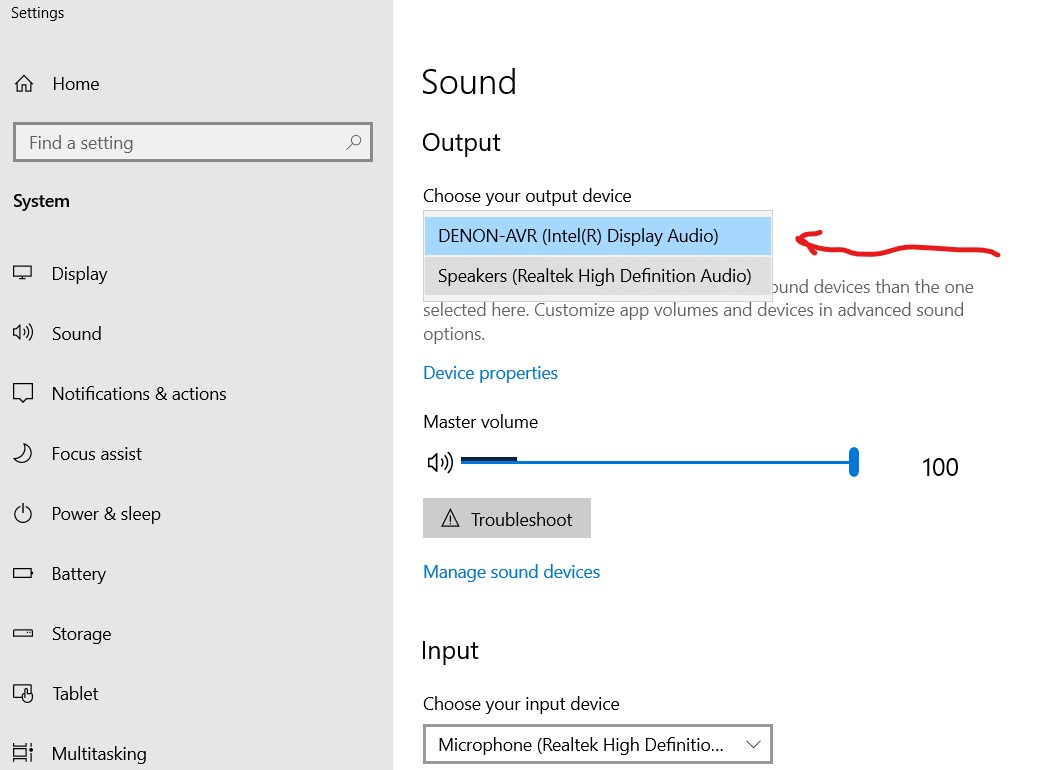

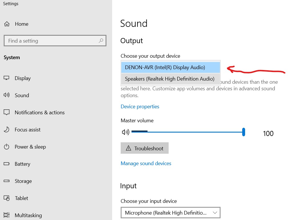

If you select Open Sound settings, the only choice you are likely to see will be the Audio Controller Realtek ALC3226. But turn off the laptop, plug in the HDMI to the Dell and the Yamaha TSR-7850 receiver, and your TV. Then turn on the receiver and TV, and select the correct HMDI input on the receiver. Restart the laptop, Open Sound settings ("right click" on the speaker icon) and this time you should have an option to select the Yamaha TSR-7850 receiver like I do with the Denon in the screen capture below:
Then you should select the Yamaha and be good to go for whatever video / audio source you play on the PC.
