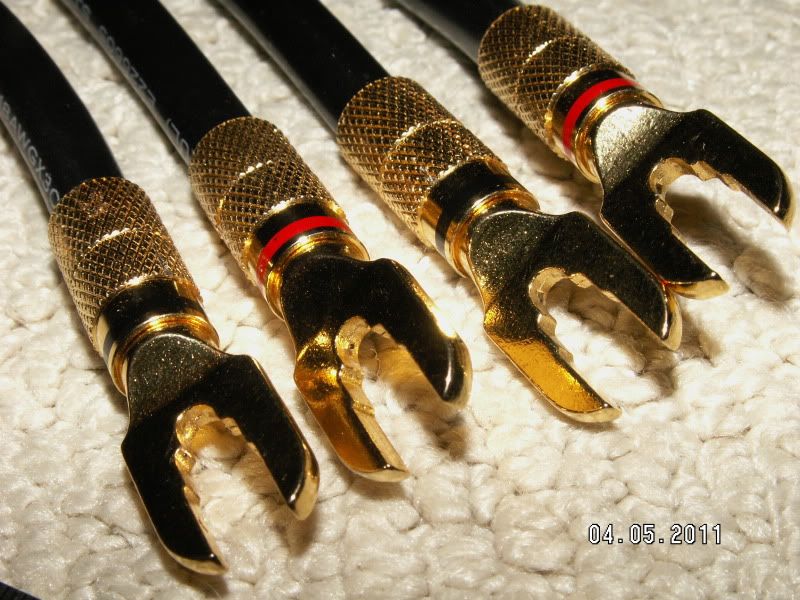

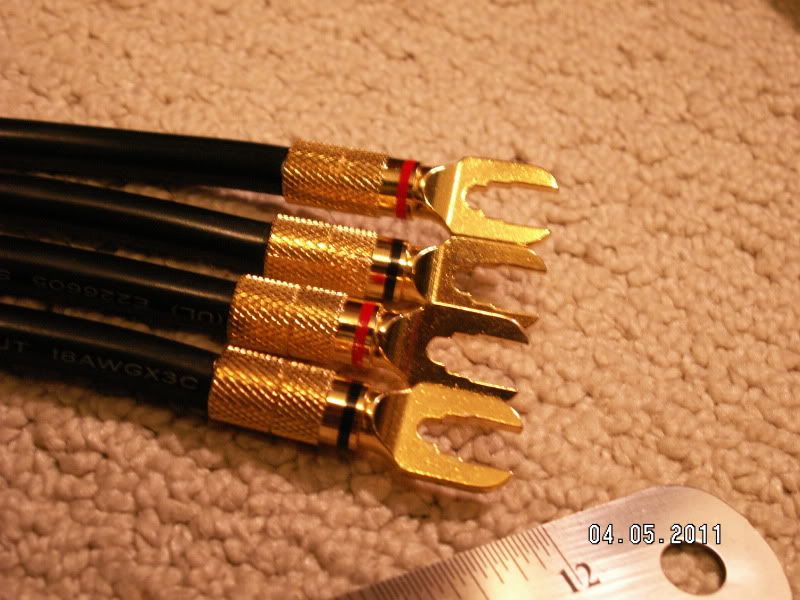

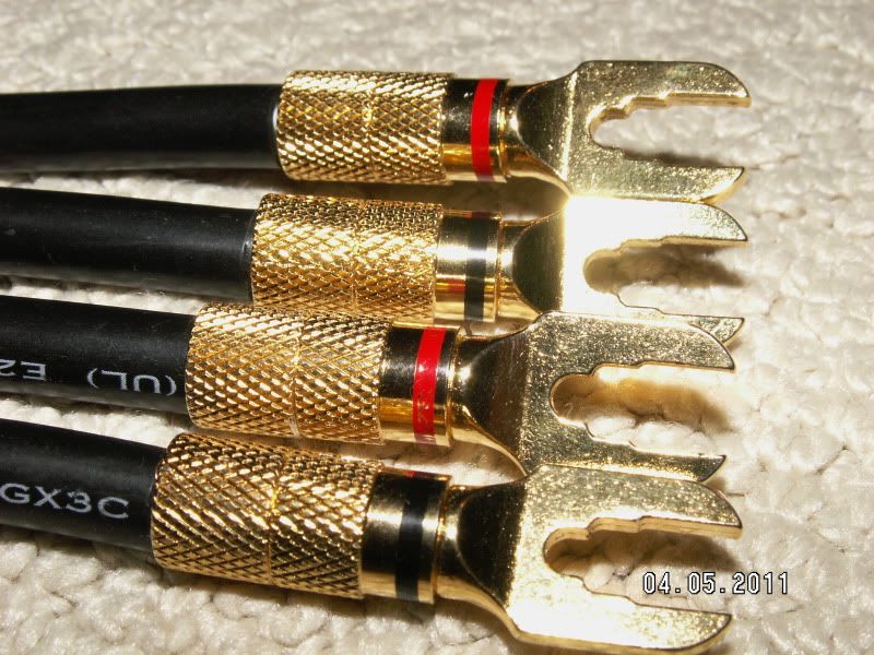

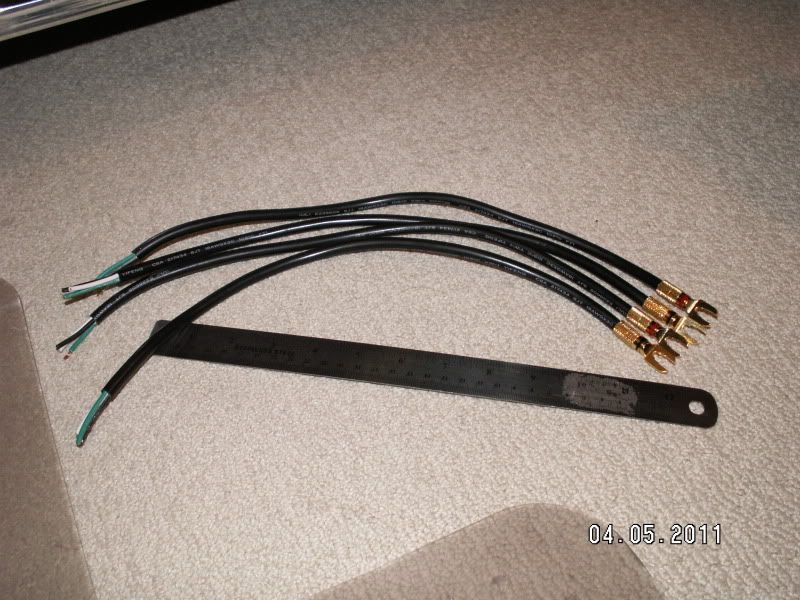

In the form of thanks I humbly submit some cable porn.
I just made these to prove I wasn't gonna do the lone 18 in conjunction with a dual 18. ;)
I told ya the shiny black jacket was pretty. Those are BJC Spades on three 18 gauge conductors which are probably equivalent to a 13.5 gauge. Whose not manly and sexy now? :p
Now the trick is to find a binding post that they fit on.
I'm not above using a nut and bolt. :eek:
