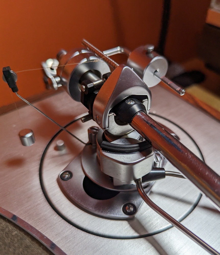

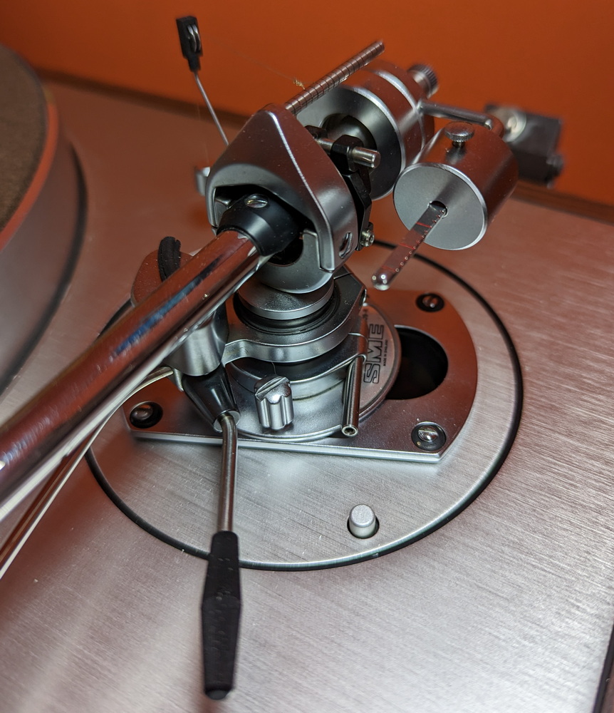

I have no clue. The instructions I downloaded are fairly useless, very little written detail and horrible illustrations. The tonearm is mounted on a cam-lock armboard specific to this turntable.
Here is the SME series II improved manual.
Now if you look at the last pages 15 and 16, you can see the rubber grommets in the arm base. You can also see there is a gap between the arm base and the turntable motor board.
If the arm base is hard against the motor board that is your problem, most likely. It could also be that the turntable is a lousy design with a resonant motor board.
I have never been a fan of Far Eastern turntables. I have personally only used Garrard and Thorens.
This is how it should look.
This is one of my SME series III arms. It is on a Thorens TD 150.
This is my other SME series III arm on a Thorens TD 125 Mk II turntable.

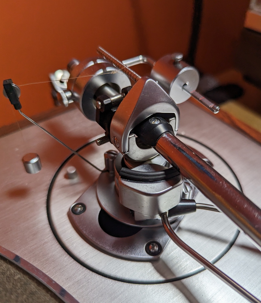

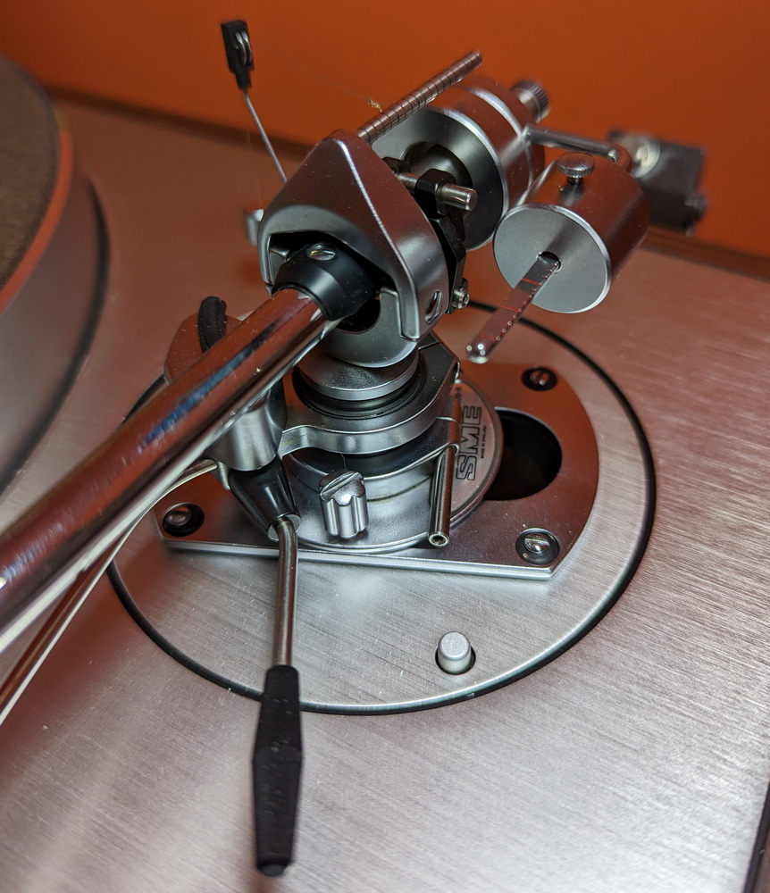

My SME 3009R tonearm is a bit different though many similarities. Should I be trying to loosen some screws or something else to try and get that transmission of touch noise down?
View attachment 61756View attachment 61757
The only difference between yours and mine, is that mine has the viscous silicone damper installed. That was an aftermarket attachment for the series II, but standard for the series III.
That arm looks to be installed correctly. So I have to conclude that that turntable has an undamped resonant chassis. I can assure the problem is not caused by the SME series II arm. I have had SME series II on my Garrard 301, which it is on now, and the Thorens TD 150 before installing the SME series III. I never encountered the problem you describe.
I would try backing off the SME mounting screws a little. The rubber grommets look over compressed.
