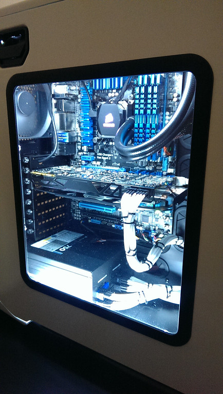

Thanks! The video card is kind of nuts, but I really don't like the way it looks. Seems to run fine though, so it will stay for now :) I am not doing full water cooling, just the water cooler on the CPU. It's a Corsair H100i water cooler, all self contained just for the CPU. So as I said the piece on the CPU is the water block, pump, and controller, then you have the lines to the radiator, all of which comes all together. You don't have to deal with filling anything, just install it like a normal heat sink (more or less) and mount the radiator and fans. This case is made for this type of cooler, and I am sure there are others that are as well.

Lets first update with a pic! I added some lights to the mix because, well why not really :) I actually had a bunch laying around for another project that wasn't working out very well. Anyway, I went to the local Micro Center with a buddy of mine the other day and got a set. Long story short, I ended up needed some of my spare parts because of how I positioned them. I needed a second transformer since my extension cables are apparently garbage. It all worked out in the end, and here is the result!
I think it looks pretty good. That same day we kind of ran through everything and got it all set up pretty well. We slightly overclocked the CPU to 3.8 (from 3.4), got the memory first running at its correct 1866 speed, and then overclocked it as well a very small amount. For some reason it was running at 1600 default, which I have seen other people say as well which is strange. Anyway we got everything up and running, put some load on it all to make sure it would stay nice and cool and called it a night. The next day I went though some optimization of the system, mostly just windows things to clear up some space and speed up the boot. I can now go from fully off to loaded in Windows in 30 second, just loading windows is somewhere around 7-8 seconds.
