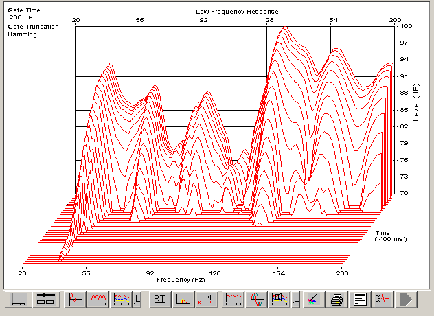

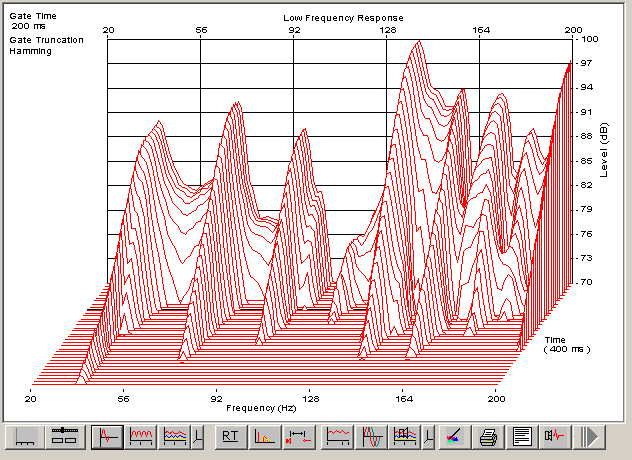

Sure, that would reduce the relative difference between a peak and its adjacent null. But the absolute null depth would stay the same.
> I'm not sure what you mean by this last statement ... They measure the peak's frequency (Hz), height from nominal (dB) and width (Q) and take the peak out. <
I'm not talking about matching the peak's Q with the equalizer's Q. Rather, I'm saying that bass traps can lower the inherent Q of the peak (widen its bandwidth) directly. The first ETF graph below shows the modal decay in a typical 16 x 11-1/2 x 8 foot room, and the second graph shows the same room after adding a bunch of our MondoTraps.
In the bottom graph you can see the two important changes good bass traps can do that EQ cannot. One is the bandwidth of the modes is widened, which means that individual bass notes will stick out less than other, adjacent notes. This solves the problem commonly known as "one note bass."
The other change is the large reduction in ringing time (the "mountains" come forward over time). Without traps, some bass notes ring out for as long as 1/3 of a second, so they muddy other subsequent bass notes. After adding bass traps the ringing time is cut in half or even less, except at the lowest mode which in this room is about 35 Hz. But even at 35 Hz there's a noticeable, if slight, improvement in bandwidth and decay time.
You'll also notice that the nulls are brought up considerably, which is yet another feature of bass traps that EQ cannot match.
Again, EQ can help to flatten the low frequency response, but it does nothing for modal bandwidth or decay time, both of which are at least as important as the raw LF response.

Having said all that we can now reply to the submitted charts-
-There is no labeling on this chart designating where in the room this reading was taken.
-Referring to the three peaks within the 20Hz -100Hz bandwidth I can truthfully say that I've never measured, at the listening position, such a severe, triple-peak case in any room I've ever encountered.
-Nor have I seen such an example brought up in any of the five CEDIA seminars I attended last October which dealt with room acoustics.
-Dr. Floyd Toole of Harman International, Anthony Grimani, ex-THX and a veteran of over 150 high end installs and John Dahl of THX taught these classes and all three were unanimous in defining the vital task of passive room correction. That task, overall is to obtain a listening space with an RT60 of between .2 and .4 seconds through the full frequency bandwidth shown at the bottom of this thread (From CEDIA Seminar 3). It will be noted that below 200Hz the .4 reverberation time is allowed to rise quite substantially but it is at this juncture that the main criteria of this discussion, flat low bass response, reverts to our initial stipulation. "At The Listening Position".
-I have seen a chart such as this. It was for a sealed, reverberant room with nothing inside but hard surfaces. So from our stance these two charts are red herrings. Again, we've got three known acousticians teaching hundreds of CEDIA grads (and now our Audioholics readers) how, and to what point passive room correction is most effective. Let's move on...
-We now concentrate on the listening position or positions and are giving our readers what we feel is a much more incisive and effective method for dealing with low frequency anomalies. At this point, flat frequency response at the listening position becomes the matter of primary import. We believe and support Dr. Toole's assertion that single-band, parametric equalization, either manual or automatic is the most direct, cost effective and acoustically correct answer. This is the simplest of options because it is so definable by actually doing the calibration at the listening position.
