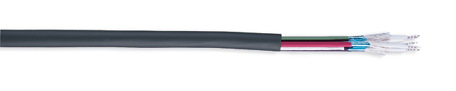

I actually used bundled mini-RGB cable (www.extron.com) which allowed for just a few cable runs to take care of all those wires. Made things much easier.

EDIT : I cant find any info about this Cable you used (Bundled Mini RGB) I've googled it and cant really find much info.

Mini-HR Cable:
http://www.extron.com/product/listbytype.asp?subtype=48
I mostly use the 5-wire type, though they have 2-wire and 6-wire as well.
