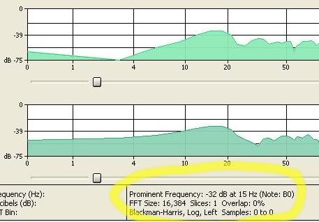

j_garcia wrote:
Originally Posted by MACCA350
War Of The Worlds, right at the start when Tom Cruze is walking off the job and talking to his boss, as a couple of truck pass in front of the screen.
Was demoing this for a friend this weekend and decided to check out this scene you're talking about. Not sure what you are referring to, as I didn't hear any LFE at all in that particular scene compared to the at least dozen or so other scenes that clearly have TONS of LFE going on.
The Grudge has some nice deep, "ominous" tones in it and I like that in a horror flick. Boogeyman had a few great LFE scenes too (too bad it wasn't a better movie).
This is whats happening at that scene, end of chapter 1, 15Hz at 4min 45sec
cheers:)

MACCA350 said:
cheers:)
I still didn't FEEL anything in that scene, like I did in many other obvious scenes in that movie is what I'm getting at. I have a subsonic filter at 14Hz, so I should be feeling some activation in the room if it is something sustainable, and I'm not.
