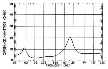

the 100's are pretty efficient speakers and shouldn't require a lot.
The 100's have an impedance dip in the bass range that begs for an external amp.
I had a thread about the 100's -vs- TLS a ways back.

Only one problem.. HK 2600 doesn't have pre-outs other than one for sub...
OP needs to go separates or new AVR + amp to get the most out of 100's
