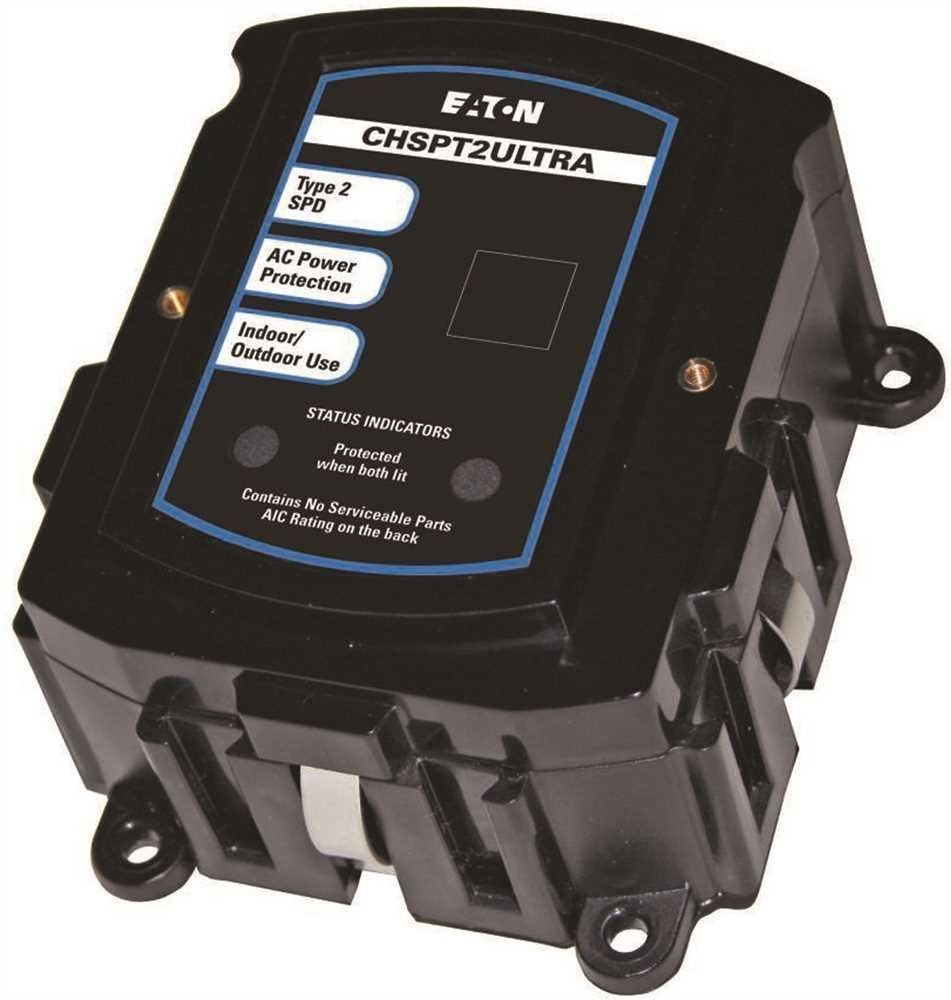

Just something like the following will suffice for probably 99% of home users, and installation could be simple and quick to do depending on the kind of electrical switch panel they have:
Note: Another one I found that seems convincingly better, by Siemens, but cost a lot much.
For the main incoming panel:

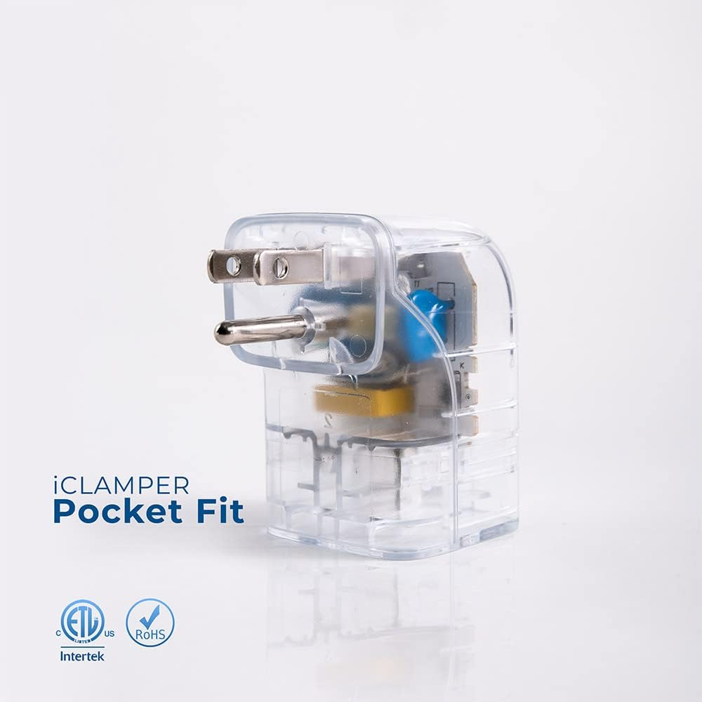

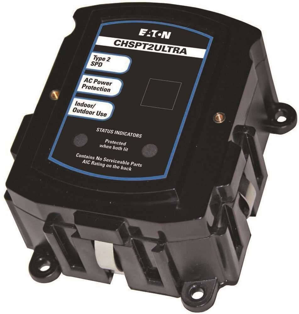

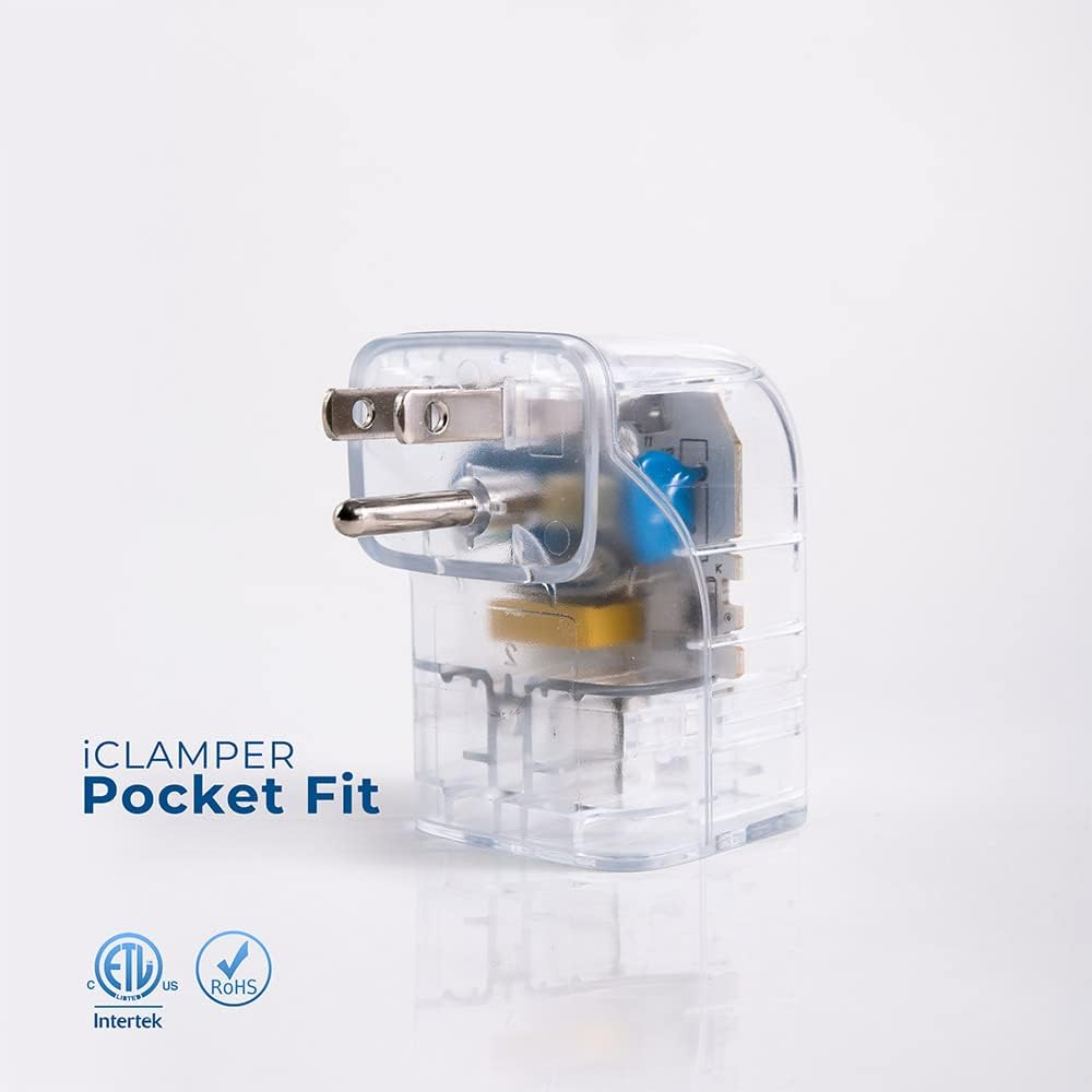

in addition, at the wall outlet when the audio devices, such as an expensive AVR, are plugged into:
I used one of this, but anything make by the likes of Siemens, Eaton kind of reputable manufacturers should be adequate:
