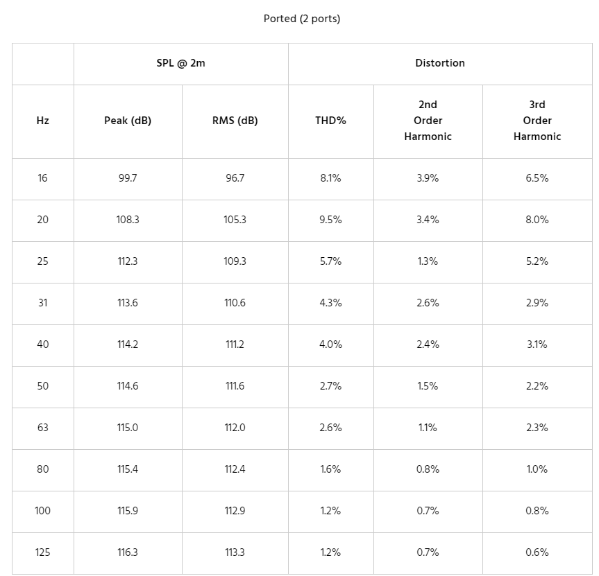

When I looked them the other day I noticed that they use 6db down on the output numbers. I will bee interested to see the 3rd party measurements. Paying for 3 Subs to go thru THX approval is interesting for monoprice as it seems they are making a hard audio push with "monolith" products.

Those numbers are very good. What is special about them is the THD and component distortion values- those are very low, as it needs to be to gain THX certification. Look at the 2nd order distortion: almost nothing. That is an extremely well designed driver. Also kudos on Monoprice for providing this amount of data, and along with the context of distortion quantities. Those do make a difference.

These look tuned comparably low and also with comparably low deep bass distortion.

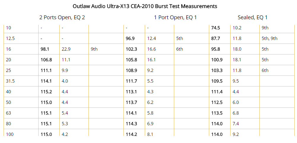

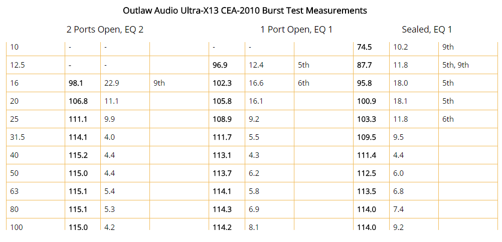

Monoprice's 12" does not best the Outlaw 13, from looking at Monoprice's measurements. You have to use the RMS measurements column on the Monoprice page. The Outlaw has higher CEA-2010 measurements.

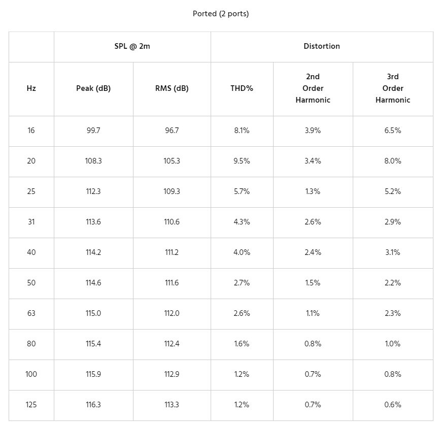

I had supposed that the burst measurements of both were directly comparable. The chart for the Outlaw 13 specifies burst readings. The chart for the Monolith has both burst and RMS. Burst measurements for the Monolith are higher than the Outlaw. The THD measurements for the Monolith aren't specified as to which column they belong in, but I suppose it's a safe bet that they're for the RMS measurements.
Either way, (and I could be wrong) it seems to me that the Monolith is better in regards to burst output. If I'm wrong I'd be happy to be shown how. outlaw 12 burst.png monolith 12 .png

CEA-2010 measurements are a bit of a mess in this regard. All CEA-2010 tests are burst tests, whether it says RMS or peak. That can mean the very peak output of the burst or a more averaged level of energy. Both are legitimate ways of looking at the measurement, since the measurement looks at energy over time. The only difference is what length of time that is considered.
The practical difference between peak and RMS is merely 3 dB. If you want to go from peak to RMS, simply subtract 3 dB. That is what Monoprice has done. These are the same test results for either metric, only difference in practical terms is 3 dB, so the distortion quantities are the same for peak or RMS since they are just different ways of look at the same measured data.
The way to compare them is to use the RMS column of the monoprice data to the audioholics measurements of the Outlaw. The Monoprice sub does not outperform the Outlaw, but it is very good for the price.
