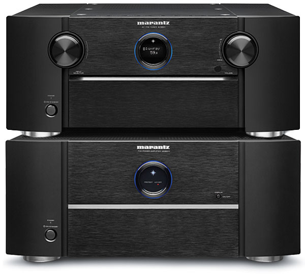

One thing nobody has mentioned here is the Marantz 8807 amplifier.
I would be curious to know how it compares and sound quality and build quality to the monolith... but also whether 150 watts per channel would be enough to drive the Polk LSiM speakers

Yes I am sorry, I meant the Marantz 8077. There is one for sale locally for $1350. My only concern is that it is only 150watts per channel, and a gross weight of like 45lbs.
