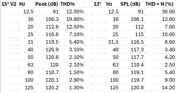

I currently use dual Hsu VTF-3 MK5 subs in my primary setup. I've recently adjusted their positioning using REW and have them fairly well optimized for reasonably good frequency response and output given a variety of placement limitations. I'm very pleased with how they sound, however, during low frequency playback at loud volumes (sub-25Hz or so) I find that port chuffing can intrude. I currently run them in EQ1 mode w/ 1 port plugged for maximum extension. I've been toying with the idea of moving to subs with large enclosures and more port area to help with ULF performance and have narrowed my options down to the Monolith 13" and 15" subs.
Per James' review, the 13" Monolith seems to out-perform the 15" at virtually all frequencies (at least with the ports open). However, in looking at Erin's reviews of each of these subs, his results are quite different. Now, I understand that there are some differences in how each reviewer measures and captures the data, so it's understandable that the numbers between both may not align precisely. However, while Erin's measurements agree with James' in that they show the 15" Monolith gives up ULF output to the newer, more powerful 13", once it reaches into the midbass, the 15" handily bests the 13". This is in stark contrast to James' findings.

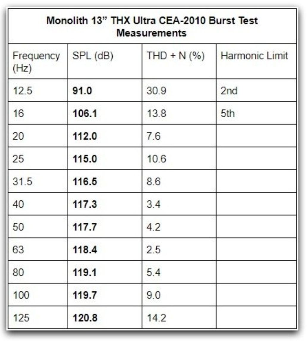

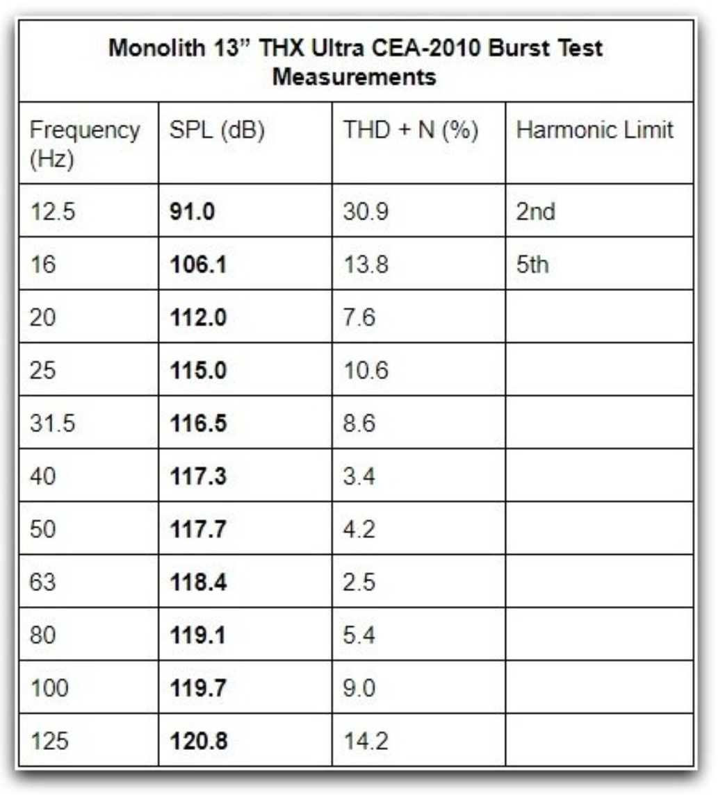

This is taken from Erin's review of the 13" Monolith:

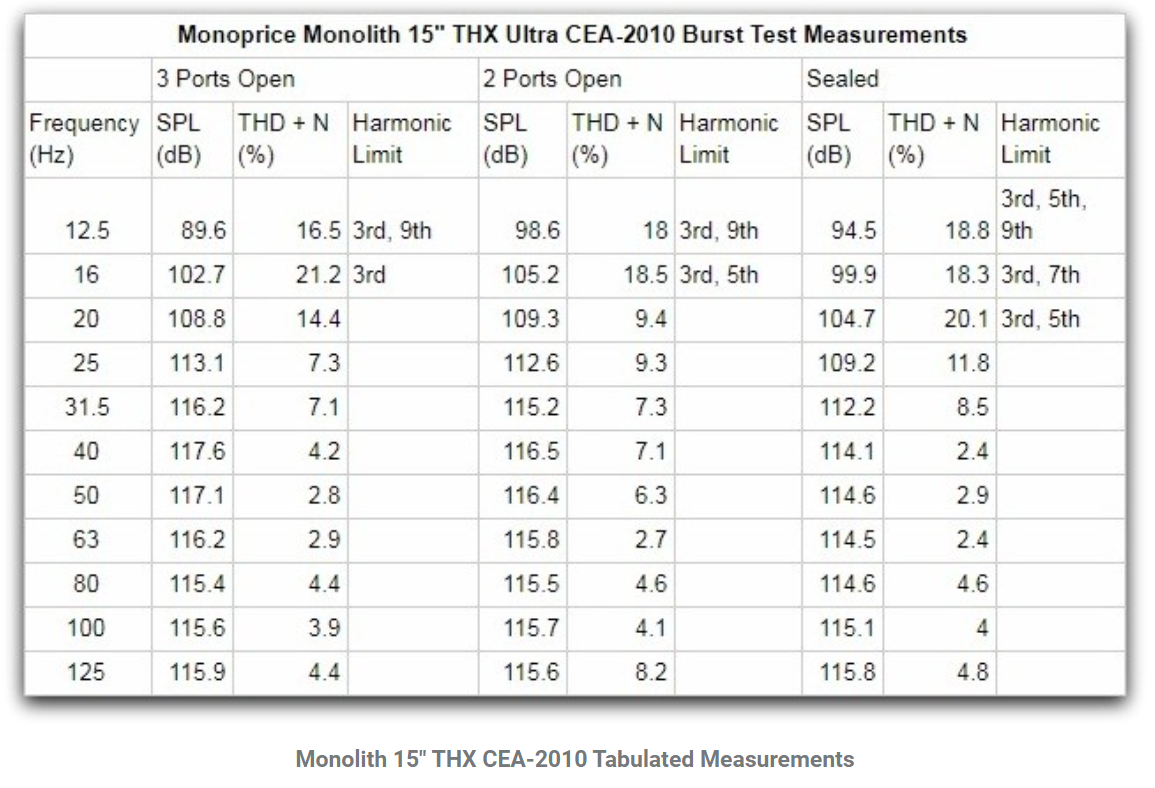

Per this table, we can see better ULF output from the 13", but once each sub rounds 30Hz, the 15" is getting twice as loud (or better).

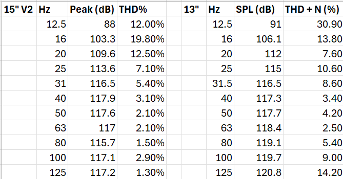

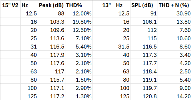

Compare this to James' data:
Based on Erin's data I'm likely going with the 15" to maintain the better midbass output. Based on James' data the 13" is an easy winner virtually everywhere. Why such a discrepancy?

I can't explain the discrepancy between Erin and my own measurements. I don't think that the 15" has more mid-bass than the 13" though. The 13" has double the wattage. Also note that my own measurements for the 15" and monoprice's measurements are fairly close. You can't go wrong with either one, but I would say the 13" is the better value at non-sale prices, especially if you are interested in big mid-bass.

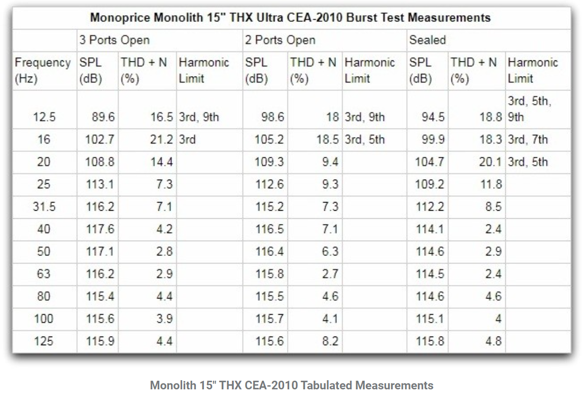

Monoprice had the 15"s up on eBay this morning at a price of $2147 shipped to my door for two of them (including tax). That's pretty hard to pass up! A few hundred more for the 13"s wouldn't be unreasonable considering you get twice the amplifier power.
Anyway, in looking at the measurements on Monoprice's website, again with all ports open for each, the 15" seems to follow the 13" fairly closely and is stronger over most of the midbass frequencies, though the gap isn't as wide as Erin's data shows. Of course, for the 13" they are using your data, but I don't know what the source of their 15" data is. I dropped both into Excel to make it easier to compare:

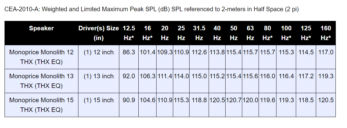

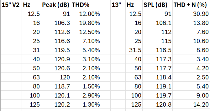

You are using the wrong data set for the 15". Use the RMS column which is to the right of the column that you used (although they still labeled it "peak", a mistake). It is the same data, but just 3dB subtracted. You will see their measurements are close to mine.

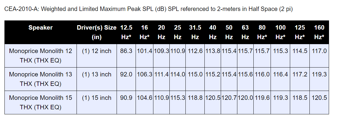

That makes more sense. I seem to recall Gene mentioning several years ago that all CEA-2010 numbers would be provided at peak output levels in reviews, not RMS, but I see now that your review mentions RMS. Monoprice looks like they've mislabeled several other subs as well (the 13" and 16" correctly show your RMS measurements). I've updated the chart to show Monoprice's published RMS numbers for the 15" V2.

I can not remember where I read this but perhaps it was Ricci’s who said all CEA/CTA 2010 numbers would have to be done by the same reviewer/method/equipment in order to have equivalent numbers. At this date, Shadyj’s are the gold standard for sub measurements.

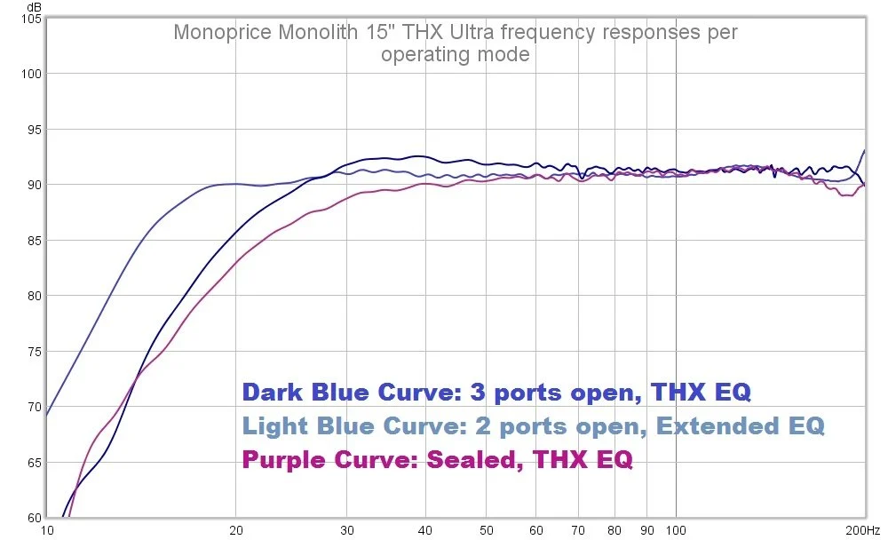

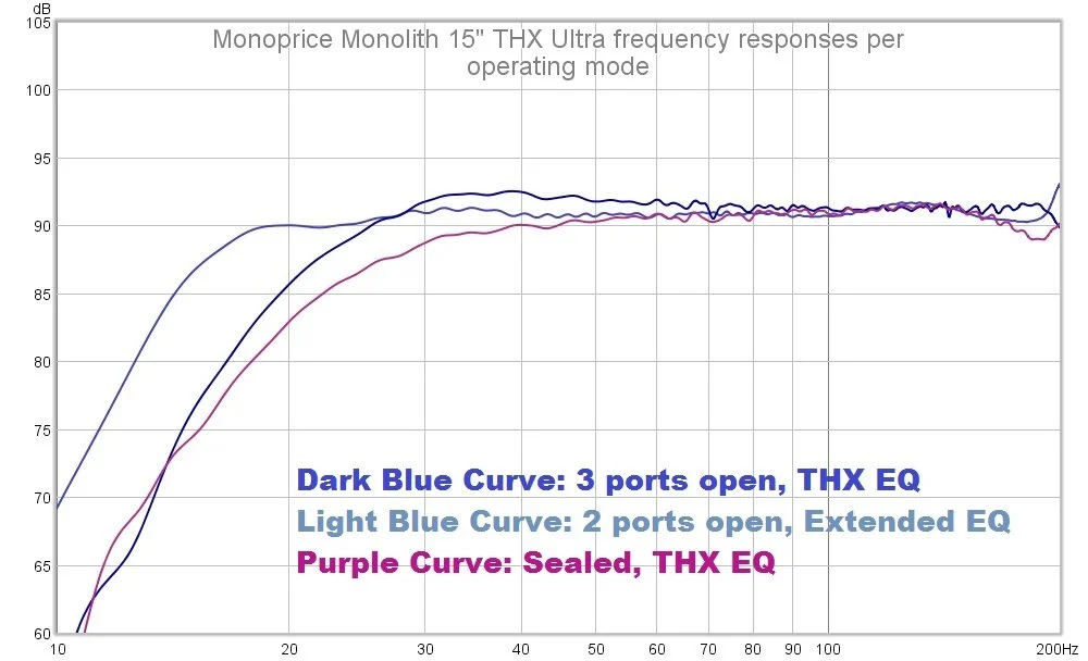

Depending on how you are defining "optimum", that can be true. I suppose the best case sub scenario (at least in a typical domestic space that's configured for good audio reproduction) would be a large number of sealed subs properly positioned and equalized. This could provide deep extension and loads of headroom with zero port-chuffing. This also wouldn't necessarily require exceedingly large boxes, just a bunch of them.
In keeping with the subs under discussion, within the limits of its size and amplification, the Monolith 15" with 1 port plugged in extended mode looks pretty well optimized to me. See James' frequency response measurements:
That's almost as ruler-flat as a sub can get (especially at its price-point), and it also offers respectable extension to under 20Hz while keeping distortion largely below audible levels (per the measurements in an earlier post). The 13" is similarly flat in its 3-port THX mode. Of course, any ported sub can be made to chuff around and below its port-tune with enough volume pumped into it.
