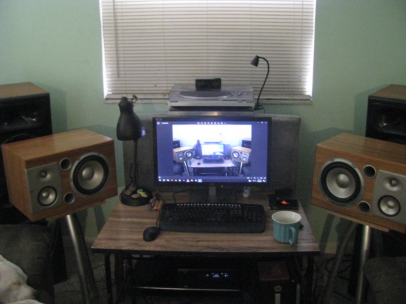

Then I got the above 3-ways from William, here. Never really thought much of them because of the low price and the rather outward, flashy appearance. Turned out to be sleepers that made me cut up my audiophile card and back to music marathons, instead. These things give one a proper thumping, without any real sacrifices to the other frequencies. Just thinking about it makes me want to set them up out here again and go for a ride. Adding the subs in from under my main speakers behind them just puts them even further over the top.
