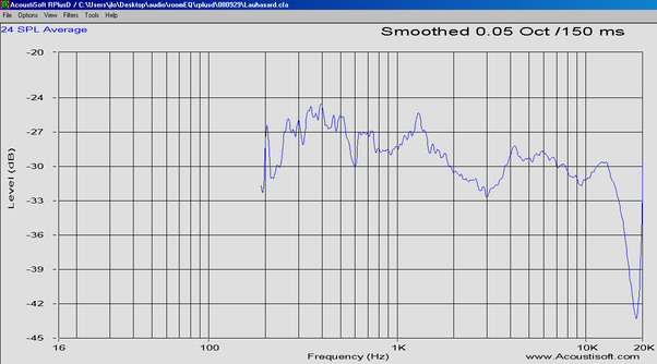

Back to the topic of primus 360 mods, has Wmax finished his work ? :)
And what are the results before/after ?
I'm asking this because I also have Primus 360. I did some tests with RplusD and here is the average of 24 measurements around listener place. I did many others but this one shows what I'd like to speak about. It shows some response peaks around 400Hz, 700Hz, 1.25kHz, 4.2kHz (some of these also appear on Stereophile measurements)
Just would like to know if anybody has got same peaks measured.
Maybe the 1.25 and 4kHz are due to diffraction.
Wmax uses a DCX2496, did he EQ something on his Primus ?
