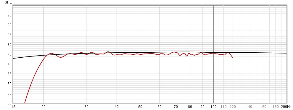

I did some tinkering on REW. After EQ this is what I got. Saw a video that instead of using a house curve in REW EQ to just instead flatten the response and to try to get it to hug the line as much as possible. I'm still a noob so I can't really say if this result is considered really good.
shadyJ
Speaker of the House
Staff member
That is an excellent response. The thing is to measure it in other positions too, to make sure the improvements aren't only for one position in space. See what the response is near that measurement position and also in other listening positions in the room.

That’s definitely an excellent response. To add to shadys points, now is when to start building the house curve, as I’m sure the way it is now will sound a little flat. No pun intended.
Thanks...sorry for the noob question but what advice can you give for setting the house curve? Thanks.
Sorry if I missed. It what are you using for eq? Minidsp? Or audyssey?
Basically you’ll want a shelf filter at 22hz(based on the graph it looks like your sub rolls off there) at maybe +5db. It should taper down to 200hz from there. I would read the link HD put up. Also, google “how to” set a house curve. Theresa lot of good info at home theater shack although it is old by now, the principles are there. I’ll be driving most of the day so hopefully you can get some help from the guys.
Used MiniDSP.
