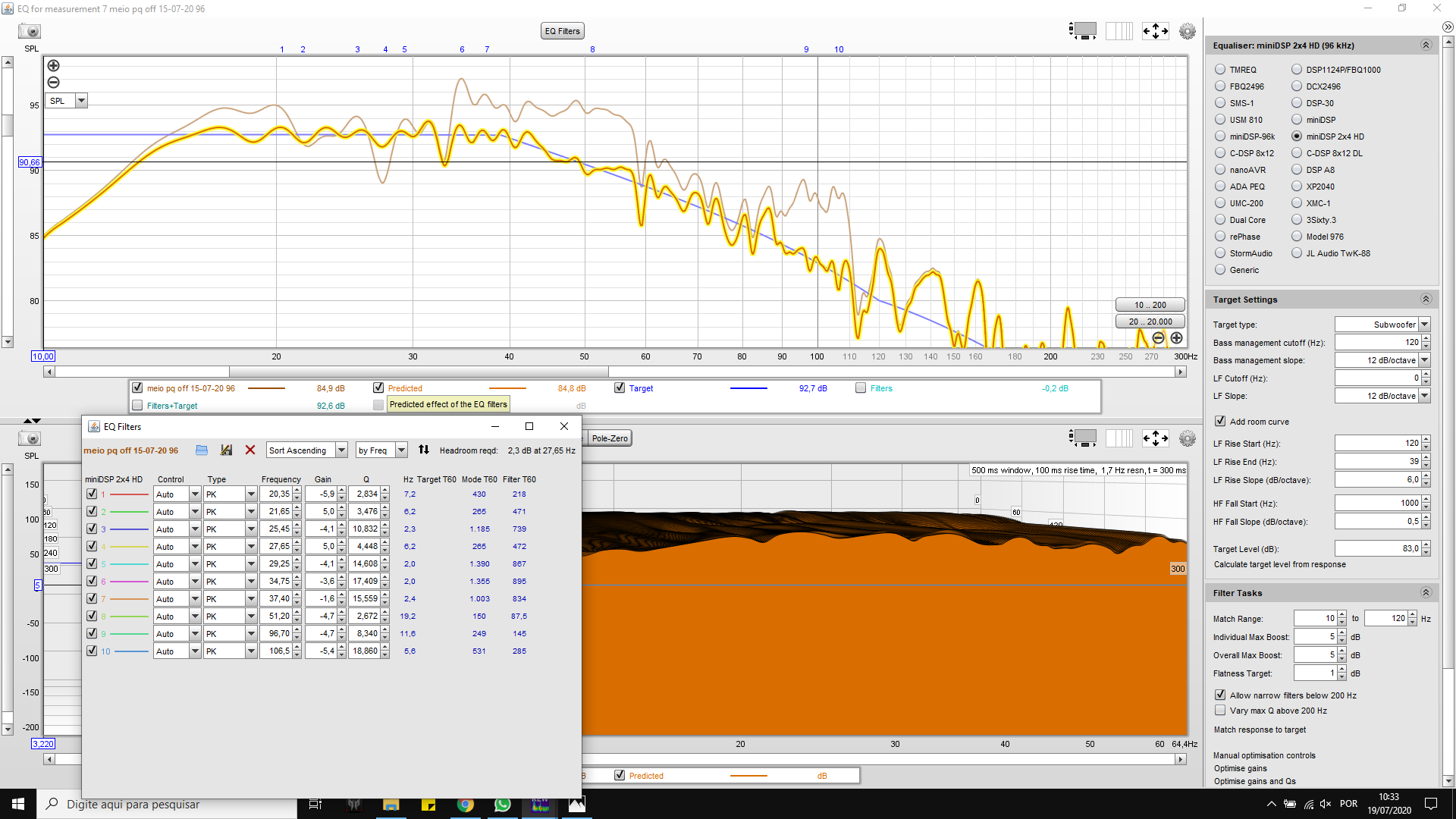

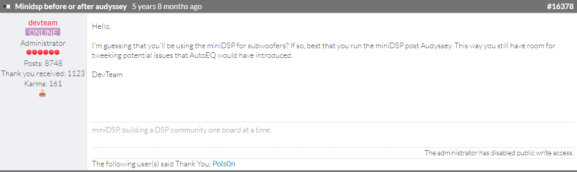

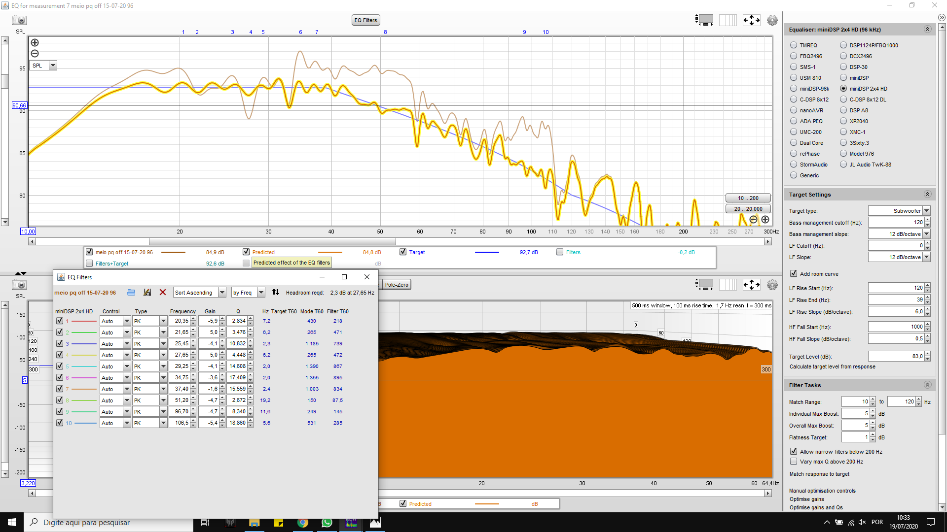

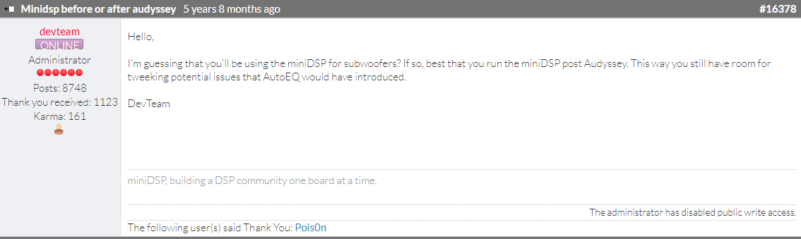

I recently bought a 2x4 hd minidsp but it still hasn't arrived, yet I'm already playing with the software rew.
I would like your opinion as to why one of the company's managers recommended applying eq after audyssey and not before how many people on youtube are doing ?
Rew filters are too high db or are in a safe range ?
Denon 4500h + 2 svs sb 3000 equal distance / Master Vol = -19 / Cross 80 and 90hz / LFE 120hz / Measured with mains + Audyssey on
The answer you got in that post says it. I've tried the mini pre Audyssey and found that in some cases Audyssey will introduce more issues and you have to go back and tweak everything with the mini again anyway. Getting your speakers set up to work with your room before running Audyssey is way more effective.
ParisB
Ultimately it doesn't matter but which way you go depends what you want to do.
It's usually better to do the more powerful tweaking (subwoofers only) with minidsp to manually align your subs and optimize their combined summation, and use filters and REW EQ to flatten your bass.
Audyssey works best as icing on the cake and does full range correction, and XT32 is good at that.
If you want your own house curve, and you did it within minidsp, then you can use the Audyssey app to disable correction in the subwoofer region. Alternatively if you kept bass flat, you can use post cal tweaks such as DEQ or tone controls etc..

I would like to use the 2 resources (Audyssey + Minidsp), I made a sketch of the house curve that the audyssey had applied and tried to keep it in Rew, because I liked the result of the audyssey, however, I didn't get to test how the final result was because the minidsp has not arrived yet.
Many youtube users are using minidsp before, to align the subs, but I'm wondering in my case that I have the subs at exactly the same distance / same model and I have the Denon 4500 Sub EQ, would there be a need for that?

Exactly what I had in mind, I already measured the left sub then the right sub and then both, apparently they are adding up without applied distance, with that I believe the best way should the minidsp after the audyssey.
