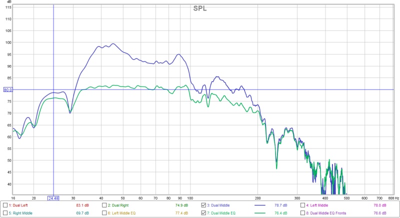

Here are my preliminary results from the addition of a miniDSP 2x4 HD into my system.
Relevent System Equipment:
Anthem MRX 710 AVR
Energy ESW-V8
Energy ESW-V10
I was going to write all sorts of things but figured I would just post a graph and let it speak for itself.
Used REW for all filter calculations and Umik-1 for measurements. Anthem's ARC room correction was NOT enabled for either measurement.
I applied filters to each sub individually and then applied another layer of global filters on top of those. No boosting, only attenuation. 80 dB target, 25 dB LF cutoff, and 160 Hz crossover.
Anthem MRX 710 AVR
Energy ESW-V8
Energy ESW-V10

Nice job but don't like that 10dB suckout at 28ish hz
PoutineHIFI
The dip is a room mode as it only appears in that listening position, still working out what I can move to sort it out.
I had my finger on the submit order button for 2 SVS PB-2000s but then decided that there was a lot I needed to learn about this hobby before I ordered new gear. I think people are far too quick to just dump money on high end gear that they don't understand or know how to make proper use of.
I'm still going to get new subs, but I am exploring the world of isolation, EQ, and acoustics first so that when I do order new gear, I will be able to make use of it properly.

Wow. Graph looks nice. That dip looks pretty narrow, doubt if you'd notice while listening. 160hz is surprising, but if it works.
PoutineHIFI
I suppose I should explain the 160 Hz. My speakers are quite small, not 160 Hz crossover small, but more the 100 Hz point. I used 160 Hz as a starting point to leave the final crossover work to the AVR. Going to run ARC tonight and see what additional corrections it may provide.
My FL and FR response above 200 Hz is horrendous, so much so that I wouldn't dare post a graph of it for fear of being run outta town but my plan is to work my way up through the frequency band correcting as I go.

I see. When you run the sweep of your LR, go into "graph" and try 1/6 smoothing. IIRC, that's about the octave resolution that humans hear at. That should straighten out your graph into something you can make sense of. I'm guessing it looks like I kid scribbling with a pencil?
PoutineHIFI
Unsmoothed, it does look like a kid scribbling with a pencil but the kid is also riding a rabid badger through the opening beach scene of Saving Private Ryan.
1/6 definitely does make things a little easier to digest. Now that the sub 200 Hz area is within an acceptable range (without buying new subs) I am going to start on investigating SBIR effects in the 200-500 Hz range.
