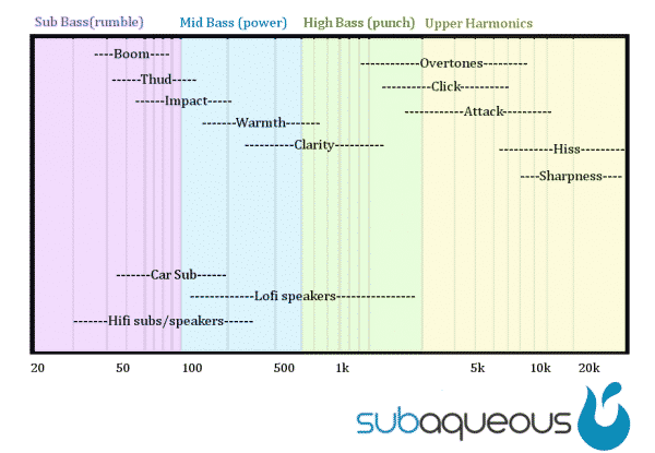

What do you consider to be mid-bass? Some people have different views on mid-bass.
This is true, there doesn't seem to be an agreed on 'standard' for what constitutes mid-bass, deep bass, and upper bass. Here are a couple different charts from a google search:
Personally I would veer to the lower chart, where 50 to 100 Hz make up mid bass. That 'sounds' right to my ears.
