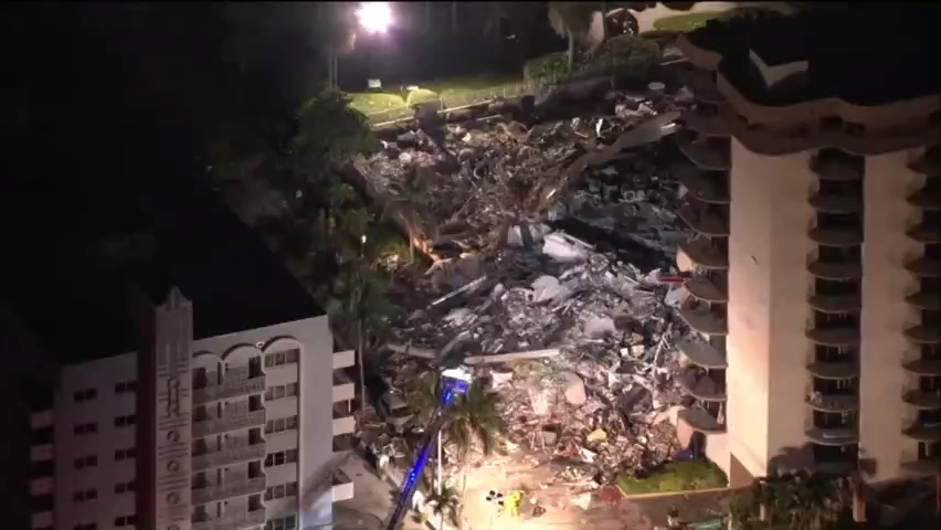

That was the other thing. Why were the concrete supports at the base so much smaller than on the left? I got the impression it was constructed in pieces.

It would be helpful to know how thick the walls are that were supporting the areas that showed spalling- the top (below the slab) is used as a beam and the width decreases the span between walls but the spalling shown is only part of the problem, which may not be visible without using some method to check the integrity of the walls, footings, etc.

This is a very good one too. This guy has construction consulting experience. Goes through the various pics during the 2018 construction analysis. The wording used in the reports (ie timely manner vs immediately). Even I can figure this stuff out by just walking down in the basement parking. Oh that doesn't look good! Hey there's rebar sticking out! Look at that huge waterline crack! Patches only cover up the problem etc. Weird they chose to do the roof first when it was reported it didn't have any leaks. When you jackhammer the roof you have to consistently go down and monitor the supports for increased stress. Really just a sad experience.
As they taught is in school- "nothing is truly 'waterproof' ".
I assume thickness matters even when concrete is absorbing moisture?
Also how much spalling is acceptable in older buildings?

Can't tell without knowing how much concrete is supposed to be there but for that place, near the water and on sand, I would assume the foundation walls and floors are supposed to be very thick. The American Concrete Institute would have the specs for allowable loss of section and spalling but that's only a symptom- when rebar rusts, it expands and when it does that, the surrounding material fractures and spalls. How much fracturing occurred is probably more important.
Being near the water comes with its own challenges, whether fresh water or salt- hydraulic pressure occurs when the soil is sandy and the structure will experience difficult loads because the pressure isn't uniformly distributed.

Another great one. He goes into the beams underground etc. Speculation but is wondering if there was any waterproofing as a chunk of the deck was taken out for inspection. Photo by a condo staff shows sitting water on the deck. The pre-collapse video he figures one of the columns had given way hence the debris at the bottom of the ramp.
