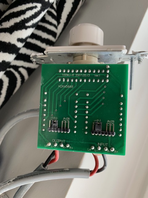

Thanks for the input everyone. Making holes isn’t an option. I don’t mind mono. We just want to listen to music. I took a pic of the volume control.
Thanks for the input everyone. Making holes isn’t an option. I don’t mind mono. We just want to listen to music. I took a pic of the volume control. View attachment 30606
That picture is no help. We need make and model number please. The only thing that picture tells me is that the output side is likely wired incorrectly.
