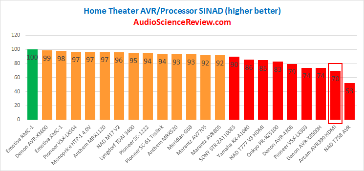

Active bi-amp, in my opinion is overrated. Objectively speaking, if done well the main benefits would be improved efficiency. Subjectively, I don't think the so called purist audiophile type would like it because of the added electronic hardware and software/processing involved.
For passive bi-amp, it is easy to do it right by simply using identical amps, and the theoretical benefits are well grounded on science, but I think very few people would believe such benefits include audible difference.
By the way, you mentioned the local guy tried to sell you an Anthem AVR. I think if you go by facts and figures, you are better off staying with the major brands such as D+M and Yamaha's. If you have time, there are quite a few reviews on ASR that allows you to compare their specs and measurements. From 20,000 ft level, you can just take a look of the chart below that compares their distortions + noise bench measurements and draw you own conclusion. I would say the MRX-1120 looks good except the high price. The MRX-520 ranks near the bottom, the only AVR that did worse than the NAD T758 V3.

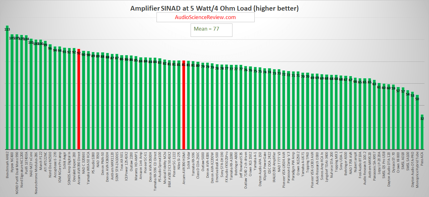

Do you have any experience with their amplifiers? The Audio Science review gave their 5000 model a recommendation but sort of damned it with faint praise: “it‘s fine for what it is,” or something along those lines. The Emotiva XPA amps seem to review well elsewhere but only their lower end was reviewed on AS.
