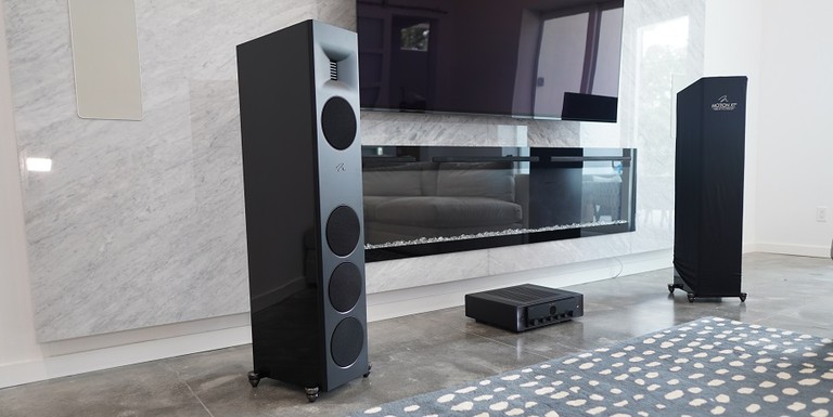

MartinLogan's XT F100 Floorstanding Speakers are a 5-driver, 3-way design that recently underwent a significant upgrade featuring a new waveguide and revamped drivers from its predecessor Motion series. The New XT F100 from MartinLogan is an aesthetically pleasing design with top-notch build quality, making it a $4,500 pair of speakers worth recommending.
  • Great build quality and looks
  • A good value for what you get
  • Good bass and dynamics
  • They sound neutral
  • They don’t measure as pristinely as the best speakers on the market
  • They may be a difficult load for lower end receivers
Quick Summary
So, throw on your favorite tunes, give these a spin, and let them serenade their way into your shortlist—because, honestly, there isn't much competition for these audio maestros! This is why the MartinLogan XT F100s won our 2023 Mid-Price Tower Speaker of the Year!
Read: MartinLogan XT F100 Floorstanding Speaker Review

So when Matthew said that he successfully powered/played the speakers with a Marantz 80WPC integrated amp, you don’t believe it?
You don’t think the reviewer tested the speakers correctly or sufficiently?
You think ML will risk getting sued by millions of people by making a speaker that will blow most AVR?
