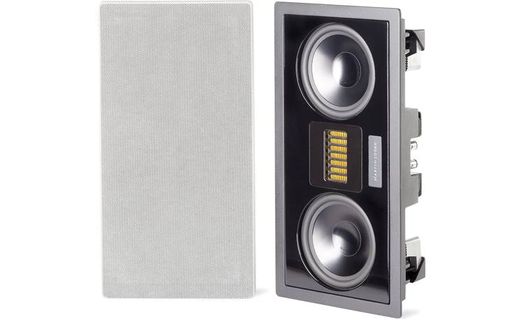

I am currently building out my basement recreation room. It's a large L-shaped space, which incorporates a small game room (14' x 12') in the "foot" of the L. Next to that is an area where in the future I will build a bar. There will be two speakers in the ceiling for ambient music in this area. My current concern is the rec room proper, next to this area, which forms a 20 x 20 x 9 space. Due to the layout, it's not a true home theater. My only option is going with ceiling speakers. For real quality stereo listening, I have pre-wired the main wall (which will be finished in real stone, and have a large screen TV - plan on the Sony Bravia 77" OLED 4K - above a Modern Flames electric fireplace). I plan to acquire - if I can finally afford them - a pair of Harbeth 30.2s (made in England). Paired with a Synthesis amp (made in Italy) these are the best sounding speakers for stereo I have ever heard, bar none.
That said, I am looking for now to find the best choice for surround sound and stereo listening, with most of the time them being used for movie surround sound.
The problem I have run into is the only venues for them are the Magnolia centers at our local Best Buys. I have been to all four locations, but none have the B&W 7.5 S2s set up. Three have the ML Vanquish set up (a pair, not three with one as center). But only the square reference 7.3s. Honestly, they sound a touch muffled when compared with the ML Vanquish set. The closest thing they appear to have to listen to for the two-way round speakers are a pair of CCM682s. Those sound quite good. But I wonder how the 7.5 S2s sound in comparison. While they are nice, in my opinion the 7.3s are a touch on the muffled side and thus not worth their $1,800 a piece price tag. I thought the Vanquishes, which run $1,600 a piece sounded better. Still pricey though. I'm looking for feedback on tbe 7.5 S2s because they are only $800 per.
Anyway. Would appreciate any feedback from those who know these speakers.

So you are just looking for surrounds no front LCR? the B&W CWM7.5's will do just fine for surround work. The ML's will also do just fine. Now if we're talking CWM7.3's for front LCR, I would have to disagree with you on the sound. I have them in my theater and they are amazing. If you are just looking for surround speakers, you don't have to spend to the nines for them. B&W CCM682's are good in-ceiling speakers.
Other speaker companies to check out are Paradigm and RBH.
Are you looking for an AVR or Processor? Anthems are nice. Nothing against Rotel or Arcam, but their name has a nice markup. You can get the same exact features with a Denon/Marantz or Yamaha for half the price. If you can get your hands on a Yamaha 2080/3080 I think you'd be doing just fine.

LCR= Left, Center, Right. Will you be adding your front three speakers into the wall by your TV? If not, you will not be getting the sound stage you're looking for. Using in-ceiling as "front stage" is not anywhere near the same as actual LCR speakers. In-ceiling are used for music and Atmos.

In ceiling is only for atmos , terrible as center channel, mediocre as surrounds . I don’t care if the ceilings speakers cost 10k ea .. still trash
Triad are king of in wall speakers.
Get in walls for front 3 or regular speakers .
Go ahead and try it tell me if I’m correct, if you already got wiring and stuff there haha ...
Good luck
Center can go below or above wall mounted tv .
