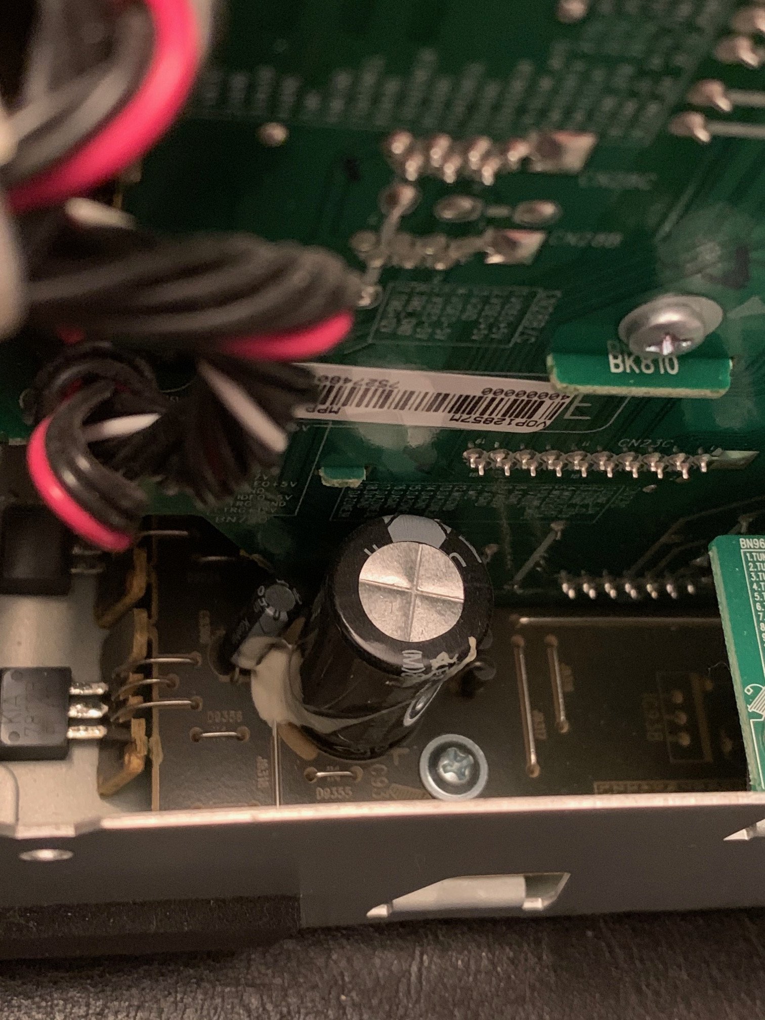

Just opened it ...no dust looks clean but found this...Is this normal?

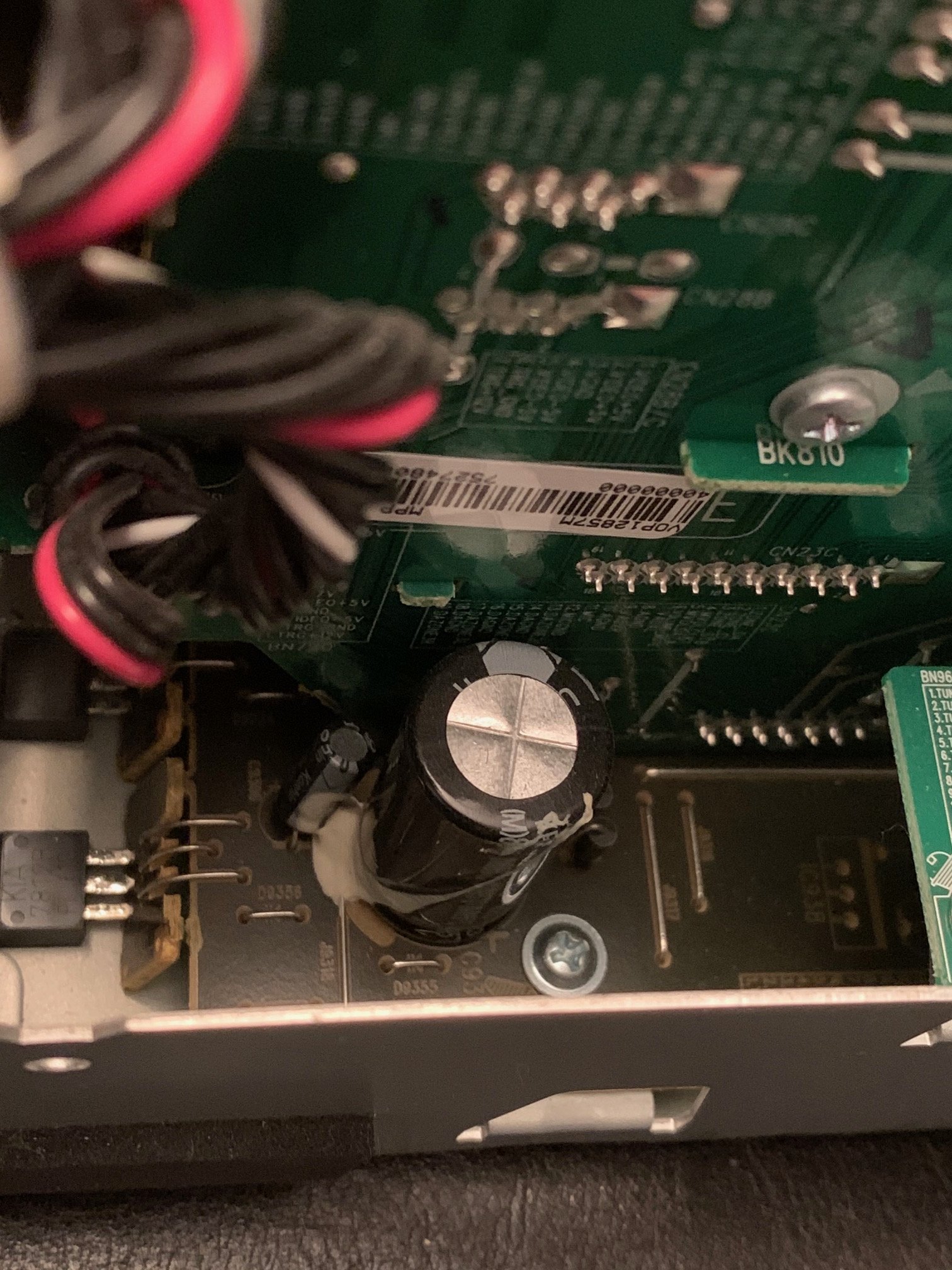

That cap has some physical damage in construction and should be replaced. However it is impossible to say if it has anything to do with your issue. It is much more likely to be due to radio frequency interference from LED bulbs as that is now so common.
