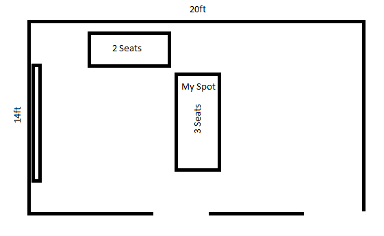

The room is very narrow, I'll probably be about 10 or 11ft away from the front speakers, 6 or 7 feet from the side speakers, and I'm not sure about the rear speakers, probably somewhere in-between. Here's a picture of what the room looks like and how the couches and TV are placed.
These are the speakers (infinityspeakers dot com/reference-series-home/), though I'm still waiting for the subwoofer 12" to go on clearance around black friday. The speakers are completely overkill for the space but I'm planning for the future with the speakers as I don't want to buy any more for a very long time. I've so far collected 4 R162s, 2 R263s, and 1 RC263 so I'm only missing the subs at this point. I got them all for a steal price wise and I'm excited to hook them up, but they definitely need some subwoofer support as they're very tailored to mids and highs from everything I've read. I've heard nothing but good things concerning their performance too.

The room is very narrow, I'll probably be about 10 or 11ft away from the front speakers, 6 or 7 feet from the side speakers, and I'm not sure about the rear speakers, probably somewhere in-between. Here's a picture of what the room looks like and how the couches and TV are placed. View attachment 26349
Thank you, now I (others may agree too..) can say for sure you will be fine with the X6400H, without the help of an external power amp, though you obviously have the option to do so should your future need arises.
