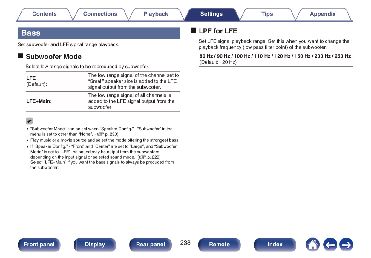

I think MattK2 pulled the number from the manual. I think a good place to start on a manual setup is to set the physical volume knob on the sub up to about 40%, crossover knob to maximum which is usually 120Hz-180Hz. Crossover at 80Hz and LPF at 120Hz. Speakers set to small and every Dynamic ANYTHING and LFE+Main OFF. Again, just a recommended starting point as tinkering will no doubt take place but you gotta’ start somewhere.
I think MattK2 pulled the number from the manual. I think a good place to start on a manual setup is to set the physical volume knob on the sub up to about 40%, crossover knob to maximum which is usually 120Hz-180Hz. Crossover at 80Hz and LPF at 120Hz. Speakers set to small and every Dynamic ANYTHING and LFE+Main OFF. Again, just a recommended starting point as tinkering will no doubt take place but you gotta’ start somewhere.View attachment 43285
They don't particularly mention that the LPF of LFE is limited to the LFE channel....yet in my similar Denon it does say limited to the LFE channel.....
