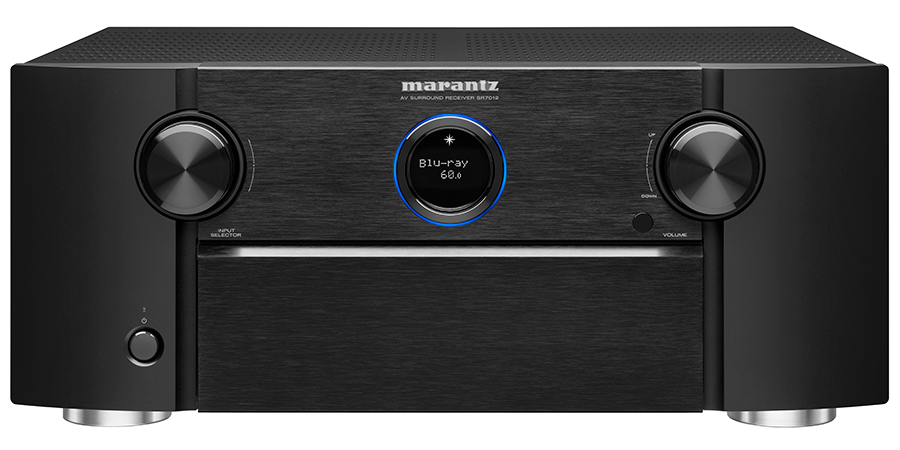

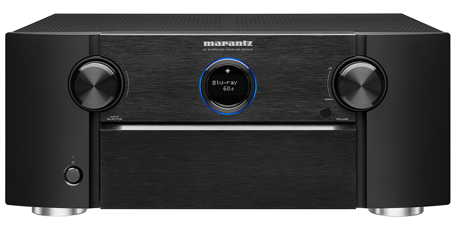

We took the new SR7012 9.2CH Marantz AV receivers for a test drive. It's among the first crop of receivers to offer Amazon Alexa voice control and AirPlay 2 support (via firmware update). Along with robust HDR support and the latest HDMI 2.0 specifications, the SR7012 is at home in both smart homes and those wanting cutting edge tech.
It's good to see Marantz list the 2CH full bandwidth power rating first on their spec sheet and they also offer a 70% guarantee.
When we pressed Marantz on the meaning of their 70% guarantee, they reported the following:
SR7012 Rated Power Output: 90.5W x5ch (72.4% of 125W) at THD+N = 0.05%
Add eleven channels of processing; nine on-board, assignable amplification modules; HEOS multi-room streaming; hi-res audio playback; and support for every major consumer 3D audio format on the market today and you’ll be hard-pressed to find a better value-laden package.
Read: Marantz SR7012 9.2CH Networking AV Receiver Review
