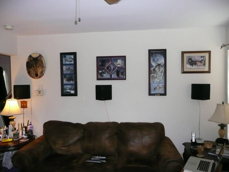

I just found this in the manual "When using a single surround back speaker, connect it to the SURROUND BACK L terminal." I can now use the center rear speaker for this purpose. This is an old picture, at least 7 years old, we now have theater recliners instead of a couch. The SR5003 allowed the use of a surround channel if you didn't have room for surround sides and surround back.
I can now use the wide surrounds as side's and the center as the lone back surround (again, I didn't initially see this). This isn't optimal but with the WAF factor, the side with the lamp on has no space for side surrounds without going high and the right side has a window. :confused:
So, for now, Marantz has given me an option until I can figure out a clean way to use 4 speakers in the back as they are supposed to be.
