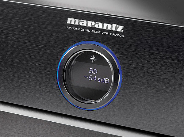

Yes, it seems like a pretty good deal, but would you stay away in light of the ASR review? I'm also not thrilled with the "port hole" display, but otherwise had been hoping they might lower prices when the 6015s were released.

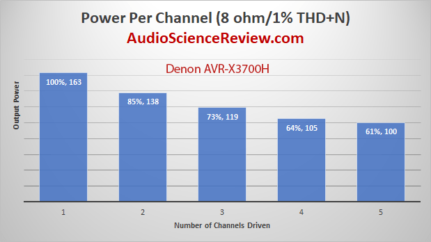

No need to be concerned about Rotel's 5 channel driven output, in real world use you won't have all 5 channel be driven to the same peak level anyway.
Rotel's specs:
1kHz, <1.0% THD, 8 ohms, DIN: 100 watts/ch (all channels driven)
Compared that to ASR's measurements on the AVR-X3700H:
So @lovinthehd was right on, when he said "I'd think the amps are relatively equal overall, and any difference in power is relatively insignificant in any case."
The SR6014 should do a little better, by may be 2 to 3% more.
